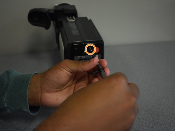

  2. Sony Betamovie BMC-220 Cassette Compartment Replacement: crwdns2935265:02crwdnd2935265:01crwdnd2935265:03crwdne2935265:0 Sony Betamovie BMC-220 Cassette Compartment Replacement: crwdns2935265:02crwdnd2935265:02crwdnd2935265:03crwdne2935265:0 Sony Betamovie BMC-220 Cassette Compartment Replacement: crwdns2935265:02crwdnd2935265:03crwdnd2935265:03crwdne2935265:0
    • Turn the BATTERY knob to OPEN, and open the lid.
    • Reminder: When inserting a new battery, make sure the knob is turned to OPEN.
    • Be careful not to point the hand grip down when turning the BATTERY knob. The battery pack may fall out.

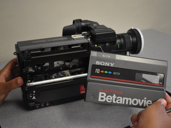

  4. Sony Betamovie BMC-220 Cassette Compartment Replacement, Cassette Compartment: crwdns2935265:04crwdnd2935265:01crwdnd2935265:03crwdne2935265:0 Sony Betamovie BMC-220 Cassette Compartment Replacement, Cassette Compartment: crwdns2935265:04crwdnd2935265:02crwdnd2935265:03crwdne2935265:0 Sony Betamovie BMC-220 Cassette Compartment Replacement, Cassette Compartment: crwdns2935265:04crwdnd2935265:03crwdnd2935265:03crwdne2935265:0
    • Remove the two screws (2mm x 6mm) at the base of the Cassette compartment using the Phillips #1 screwdriver.
    • Remove the two screws (2mm x 6mm) at the back of the Betamovie using the Phillips #2 screwdriver.
    • Once all of the screws are removed, pop the cassette cover off of the camera.

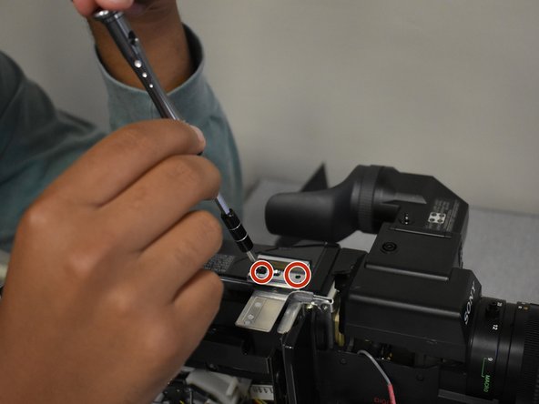

  5. Sony Betamovie BMC-220 Cassette Compartment Replacement: crwdns2935265:05crwdnd2935265:01crwdnd2935265:02crwdne2935265:0 Sony Betamovie BMC-220 Cassette Compartment Replacement: crwdns2935265:05crwdnd2935265:02crwdnd2935265:02crwdne2935265:0
    • Remove the silver piece at the top of the Betamovie using your hands.
    • Remove the two screws (2mm x 6mm) under the flat silver piece using the Phillips #1 screwdriver. The silver metal clip comes off once the crews are removed.

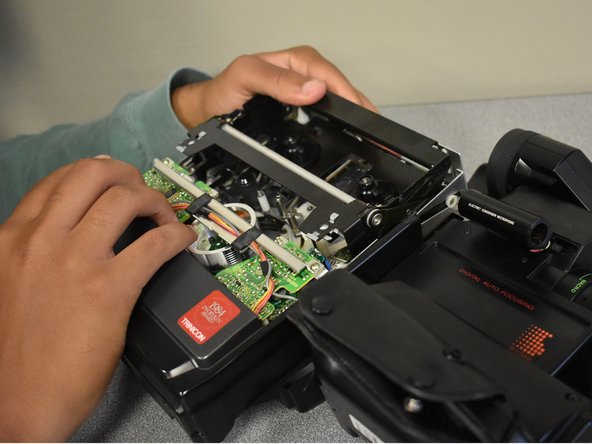

  6. Sony Betamovie BMC-220 Cassette Compartment Replacement: crwdns2935265:06crwdnd2935265:01crwdnd2935265:02crwdne2935265:0 Sony Betamovie BMC-220 Cassette Compartment Replacement: crwdns2935265:06crwdnd2935265:02crwdnd2935265:02crwdne2935265:0
    • Remove the two screws (2mm x 6mm) underneath the cassette compartment on the bottom of the Betamovie with the Phillips #1 screwdriver.
    • Remove the bottom piece of the cassette compartment.
