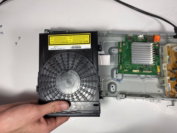

  9. Sony BDP-s7200 Disk Drive Replacement, Disk Drive: crwdns2935265:09crwdnd2935265:01crwdnd2935265:02crwdne2935265:0 Sony BDP-s7200 Disk Drive Replacement, Disk Drive: crwdns2935265:09crwdnd2935265:02crwdnd2935265:02crwdne2935265:0
    • Using the Phillips #2 Screwdriver, unscrew the four 9mm screws from disk drive.
    • Disconnect the 3 ribbon cables connecting the disk drive to the motherboard
    • Pull the disk drive from the device to remove it.
