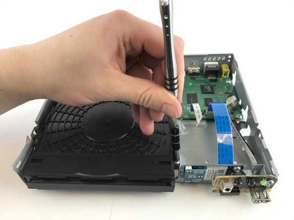

  5. Sony BDP-S3700 Motherboard Replacement, Disc Drive: crwdns2935265:05crwdnd2935265:01crwdnd2935265:03crwdne2935265:0 Sony BDP-S3700 Motherboard Replacement, Disc Drive: crwdns2935265:05crwdnd2935265:02crwdnd2935265:03crwdne2935265:0 Sony BDP-S3700 Motherboard Replacement, Disc Drive: crwdns2935265:05crwdnd2935265:03crwdnd2935265:03crwdne2935265:0
    • Flip the Blu-ray back up
    • Remove the three ribbon cables that connect the disc drive to the motherboard.
    • Handle the circuits only on its side.
  6. Sony BDP-S3700 Motherboard Replacement: crwdns2935265:06crwdnd2935265:01crwdnd2935265:02crwdne2935265:0 Sony BDP-S3700 Motherboard Replacement: crwdns2935265:06crwdnd2935265:02crwdnd2935265:02crwdne2935265:0
    • Use a PH1 screwdriver to unscrew both of the 7mm screws on the side of the disc reader.
  7. Sony BDP-S3700 Motherboard Replacement: crwdns2935265:07crwdnd2935265:01crwdnd2935265:01crwdne2935265:0
    • Gently slide the disc drive to the right and lift up to remove the disc drive from the body of the player.

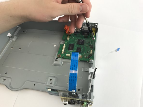

  8. Sony BDP-S3700 Motherboard Replacement, Motherboard: crwdns2935265:08crwdnd2935265:01crwdnd2935265:02crwdne2935265:0 Sony BDP-S3700 Motherboard Replacement, Motherboard: crwdns2935265:08crwdnd2935265:02crwdnd2935265:02crwdne2935265:0
    • Gently pull upwards on the ribbon cables to disconnect the motherboard from the Wi-Fi module and port board.

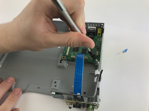

  9. Sony BDP-S3700 Motherboard Replacement: crwdns2935265:09crwdnd2935265:01crwdnd2935265:03crwdne2935265:0 Sony BDP-S3700 Motherboard Replacement: crwdns2935265:09crwdnd2935265:02crwdnd2935265:03crwdne2935265:0 Sony BDP-S3700 Motherboard Replacement: crwdns2935265:09crwdnd2935265:03crwdnd2935265:03crwdne2935265:0
    • Remove the three 7mm screws along the motherboard using a PH1 screwdriver.
  10. Sony BDP-S3700 Motherboard Replacement: crwdns2935265:010crwdnd2935265:01crwdnd2935265:03crwdne2935265:0 Sony BDP-S3700 Motherboard Replacement: crwdns2935265:010crwdnd2935265:02crwdnd2935265:03crwdne2935265:0 Sony BDP-S3700 Motherboard Replacement: crwdns2935265:010crwdnd2935265:03crwdnd2935265:03crwdne2935265:0
    • Remove the 4mm screw above the HDMI port and the 9mm screw Digital Out port.
  11. Sony BDP-S3700 Motherboard Replacement: crwdns2935265:011crwdnd2935265:01crwdnd2935265:01crwdne2935265:0
    • Carefully lift and pull the motherboard forward to remove.
