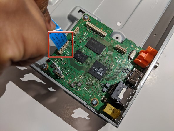

    1. Sony BDP-S3500 Wi-Fi Module Replacement, Port Board: crwdns2935265:04crwdnd2935265:01crwdnd2935265:02crwdne2935265:0 Sony BDP-S3500 Wi-Fi Module Replacement, Port Board: crwdns2935265:04crwdnd2935265:02crwdnd2935265:02crwdne2935265:0
      • Keep the back side up and facing towards you.
      • Carefully disconnect the blue ribbon connecting the port board and motherboard.
      • Be delicate while removing the ribbon.
    2. Sony BDP-S3500 Wi-Fi Module Replacement: crwdns2935265:05crwdnd2935265:01crwdnd2935265:01crwdne2935265:0
      • Use a Phillips #2 screwdriver to remove the 9mm screw from the port board.
    3. Sony BDP-S3500 Wi-Fi Module Replacement: crwdns2935265:06crwdnd2935265:01crwdnd2935265:01crwdne2935265:0
      • Remove the port board from the device.
