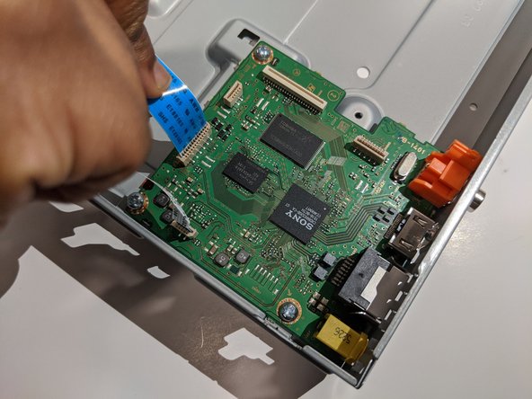

  7. Sony BDP-S3500 Motherboard Replacement, Motherboard: crwdns2935265:07crwdnd2935265:01crwdnd2935265:02crwdne2935265:0 Sony BDP-S3500 Motherboard Replacement, Motherboard: crwdns2935265:07crwdnd2935265:02crwdnd2935265:02crwdne2935265:0
    • Remove the ribbon cables by holding onto the cable and gently pulling straight up.
  8. Sony BDP-S3500 Motherboard Replacement: crwdns2935265:08crwdnd2935265:01crwdnd2935265:03crwdne2935265:0 Sony BDP-S3500 Motherboard Replacement: crwdns2935265:08crwdnd2935265:02crwdnd2935265:03crwdne2935265:0 Sony BDP-S3500 Motherboard Replacement: crwdns2935265:08crwdnd2935265:03crwdnd2935265:03crwdne2935265:0
    • Use the Phillips #2 screwdriver to remove three 9mm screws securing the motherboard to the case.
    • Remove one 5.5mm Phillips #2 from the back of the case near the ports.
  9. Sony BDP-S3500 Motherboard Replacement: crwdns2935265:09crwdnd2935265:01crwdnd2935265:01crwdne2935265:0
    • Slide the motherboard away from the back of the case and then lift up to remove.
