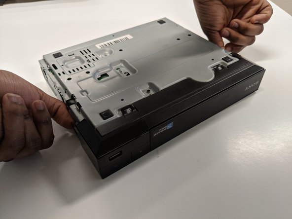

  3. Sony BDP-S3500 Disk Drive Replacement: crwdns2935265:03crwdnd2935265:01crwdnd2935265:02crwdne2935265:0 Sony BDP-S3500 Disk Drive Replacement: crwdns2935265:03crwdnd2935265:02crwdnd2935265:02crwdne2935265:0
    • Unclip the plastic tags from the bottom of the device.
    • Unclip the plastic tags from the sides of the device.
    • Slide the front panel off.

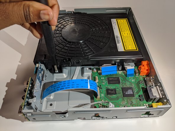

  5. Sony BDP-S3500 Disk Drive Replacement: crwdns2935265:05crwdnd2935265:01crwdnd2935265:02crwdne2935265:0 Sony BDP-S3500 Disk Drive Replacement: crwdns2935265:05crwdnd2935265:02crwdnd2935265:02crwdne2935265:0
    • Use a Phillips #2 screwdriver to remove the two 9mm screws that are holding the disk drive in place.
  6. Sony BDP-S3500 Disk Drive Replacement: crwdns2935265:06crwdnd2935265:01crwdnd2935265:02crwdne2935265:0 Sony BDP-S3500 Disk Drive Replacement: crwdns2935265:06crwdnd2935265:02crwdnd2935265:02crwdne2935265:0
    • Carefully lift and slide the disk drive out of the casing.
