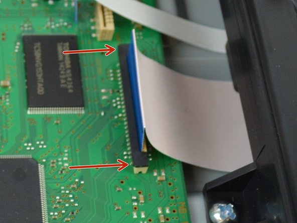

    • Carefully detach the white strips from the motherboard.
    • Be sure to lift the black latch for the largest strip next to the disc drive before removing it.

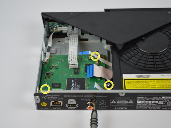

    • Remove screw above HDMI OUT port.
    • Remove screw above DIGITAL OUT port.

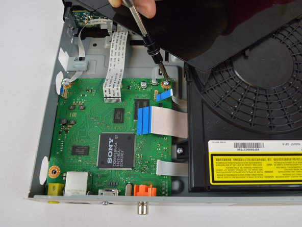

    • Remove the three screws on the motherboard.
    • Use a #1 Phillips screwdriver to remove all screws.

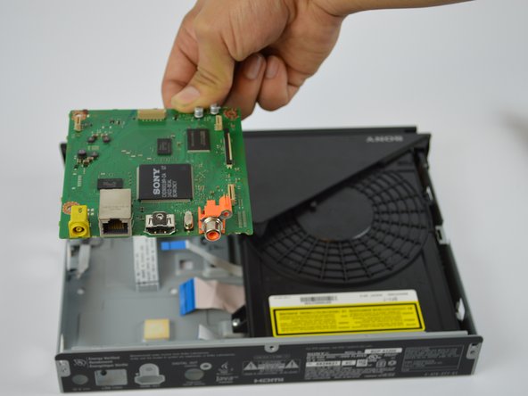

    • Remove motherboard from the device.
    • Be careful not to damage any components of the motherboard when removing it from the device.
