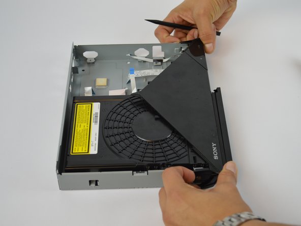

    • Locate the disk drive
  5. Sony BDP-S3200  Disk Tray Belt Replacement: crwdns2935265:05crwdnd2935265:01crwdnd2935265:03crwdne2935265:0 Sony BDP-S3200  Disk Tray Belt Replacement: crwdns2935265:05crwdnd2935265:02crwdnd2935265:03crwdne2935265:0 Sony BDP-S3200  Disk Tray Belt Replacement: crwdns2935265:05crwdnd2935265:03crwdnd2935265:03crwdne2935265:0

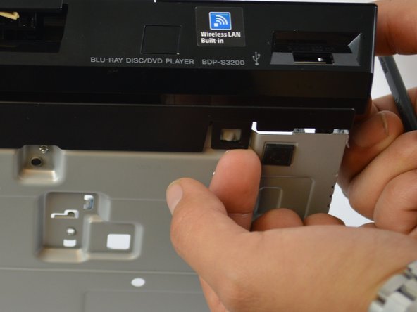

    • Lightly lift off the hook on both front rear side and the bottom of the device to remove the front panel

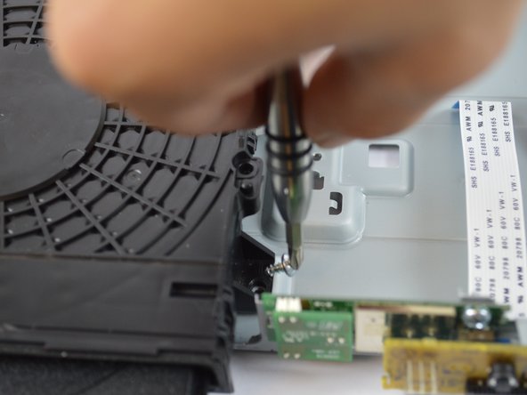

  6. Sony BDP-S3200  Disk Tray Belt Replacement: crwdns2935265:06crwdnd2935265:01crwdnd2935265:02crwdne2935265:0 Sony BDP-S3200  Disk Tray Belt Replacement: crwdns2935265:06crwdnd2935265:02crwdnd2935265:02crwdne2935265:0
    • Remove the two screws that attach the disk drive to the frame using a #1 Phillips screwdriver.

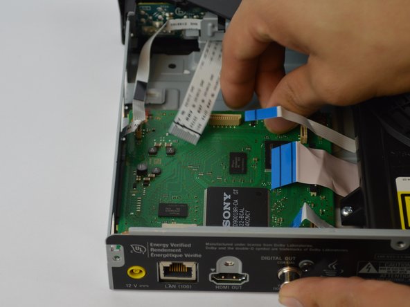

    • Carefully pull the (3) three bands off vertically.
    • NOTE: There is a latch that needs to be lifted off before pulling the band out for the middle band.

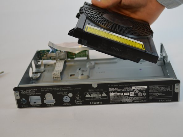

  8. Sony BDP-S3200  Disk Tray Belt Replacement: crwdns2935265:08crwdnd2935265:01crwdnd2935265:02crwdne2935265:0 Sony BDP-S3200  Disk Tray Belt Replacement: crwdns2935265:08crwdnd2935265:02crwdnd2935265:02crwdne2935265:0
    • Lift the disk drive off of the device

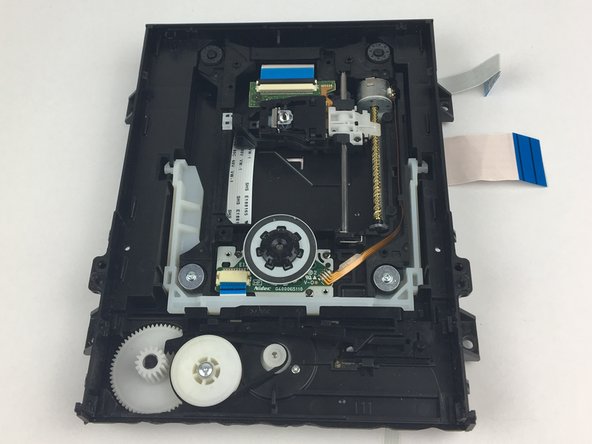

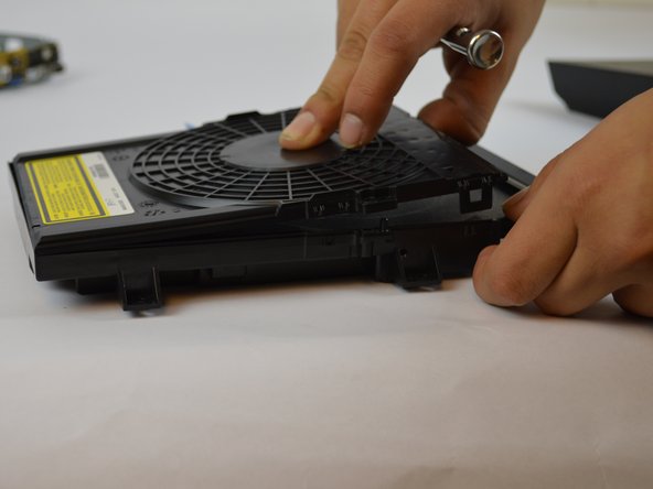

  9. Sony BDP-S3200  Disk Tray Belt Replacement, Disk Tray Belt: crwdns2935265:09crwdnd2935265:01crwdnd2935265:03crwdne2935265:0 Sony BDP-S3200  Disk Tray Belt Replacement, Disk Tray Belt: crwdns2935265:09crwdnd2935265:02crwdnd2935265:03crwdne2935265:0 Sony BDP-S3200  Disk Tray Belt Replacement, Disk Tray Belt: crwdns2935265:09crwdnd2935265:03crwdnd2935265:03crwdne2935265:0
    • Remove the top of the disk drive by gently lifting up on the four latches located on both sides of the disk drive while lifting upwards.
    • The latches are very thin and can break off easily so make sure to use caution when lifting them to remove the disk drive top.

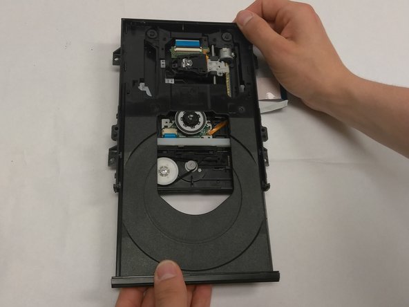

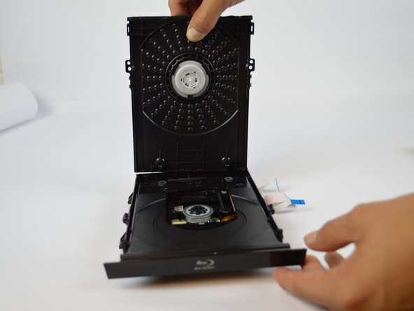

  10. Sony BDP-S3200  Disk Tray Belt Replacement: crwdns2935265:010crwdnd2935265:01crwdnd2935265:03crwdne2935265:0 Sony BDP-S3200  Disk Tray Belt Replacement: crwdns2935265:010crwdnd2935265:02crwdnd2935265:03crwdne2935265:0 Sony BDP-S3200  Disk Tray Belt Replacement: crwdns2935265:010crwdnd2935265:03crwdnd2935265:03crwdne2935265:0
    • Slide out the disk tray.
    • If the disk tray does not come out easily don’t force it out this could break the gears that allow the tray to move. Gently lift the disk tray upwards while sliding it out.

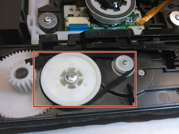

  11. Sony BDP-S3200  Disk Tray Belt Replacement: crwdns2935265:011crwdnd2935265:01crwdnd2935265:02crwdne2935265:0 Sony BDP-S3200  Disk Tray Belt Replacement: crwdns2935265:011crwdnd2935265:02crwdnd2935265:02crwdne2935265:0
    • Remove the disc tray belt.
