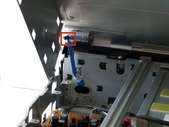

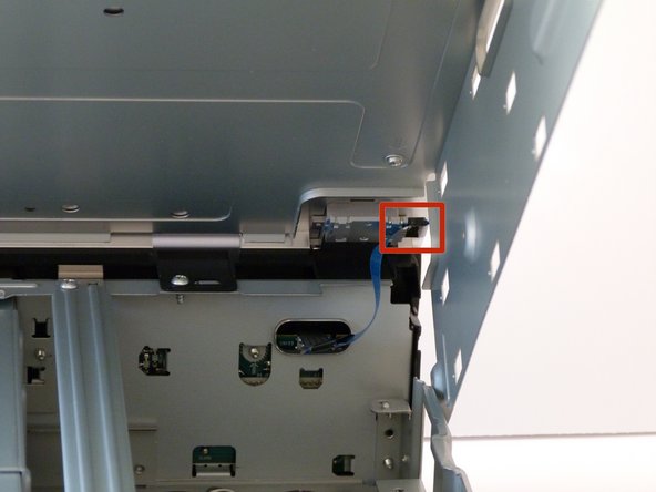

  3. Sony BDP-S1 Optical Drive Motor Replacement: crwdns2935265:03crwdnd2935265:01crwdnd2935265:03crwdne2935265:0 Sony BDP-S1 Optical Drive Motor Replacement: crwdns2935265:03crwdnd2935265:02crwdnd2935265:03crwdne2935265:0 Sony BDP-S1 Optical Drive Motor Replacement: crwdns2935265:03crwdnd2935265:03crwdnd2935265:03crwdne2935265:0
    • Potential for device damage: Carefully lift up the top panel, because there are two blue ribbon cables that must be disconnected before removing the panel, and we do NOT want them to break.
    • After gently disconnecting the two ribbon cables (you can just pull them out with your hand), take the top off and set it to the side.

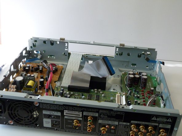

  4. Sony BDP-S1 Optical Drive Motor Replacement: crwdns2935265:04crwdnd2935265:01crwdnd2935265:03crwdne2935265:0 Sony BDP-S1 Optical Drive Motor Replacement: crwdns2935265:04crwdnd2935265:02crwdnd2935265:03crwdne2935265:0 Sony BDP-S1 Optical Drive Motor Replacement: crwdns2935265:04crwdnd2935265:03crwdnd2935265:03crwdne2935265:0

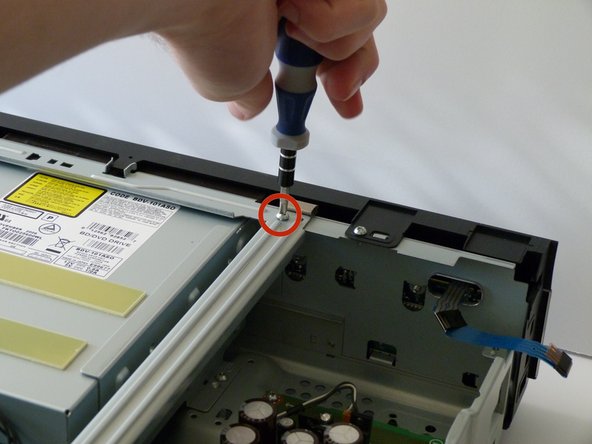

    • After the top is off, you'll see that there are two metal bars that go across the top of the device.
    • Remove each bar by unscrewing the two 10mm silver screws on each end.

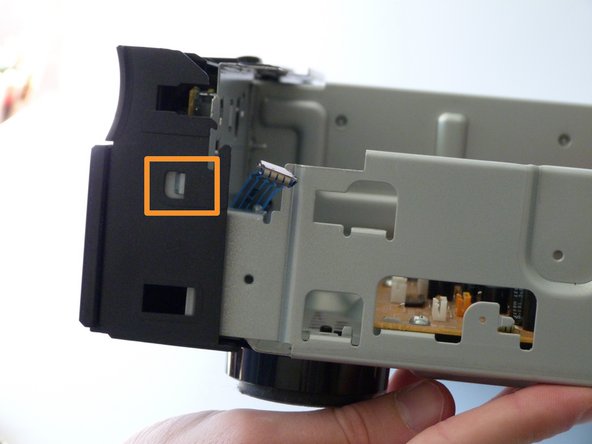

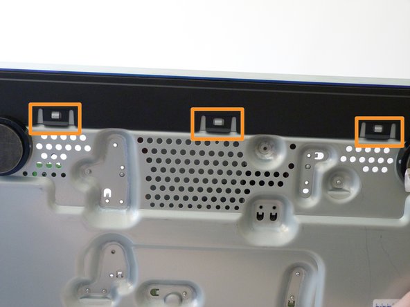

  5. Sony BDP-S1 Optical Drive Motor Replacement, Optical Drive: crwdns2935265:05crwdnd2935265:01crwdnd2935265:03crwdne2935265:0 Sony BDP-S1 Optical Drive Motor Replacement, Optical Drive: crwdns2935265:05crwdnd2935265:02crwdnd2935265:03crwdne2935265:0 Sony BDP-S1 Optical Drive Motor Replacement, Optical Drive: crwdns2935265:05crwdnd2935265:03crwdnd2935265:03crwdne2935265:0
    • Remove the two 10mm silver screws holding the front panel on with the Phillips #2 screwdriver, located on the top side of the front panel.
    • Take off the front panel by depressing the clips (either with your fingers, screwdriver, or other small object) and pulling it off.
    • There are two clips on the top, one on each side, and three on the bottom.

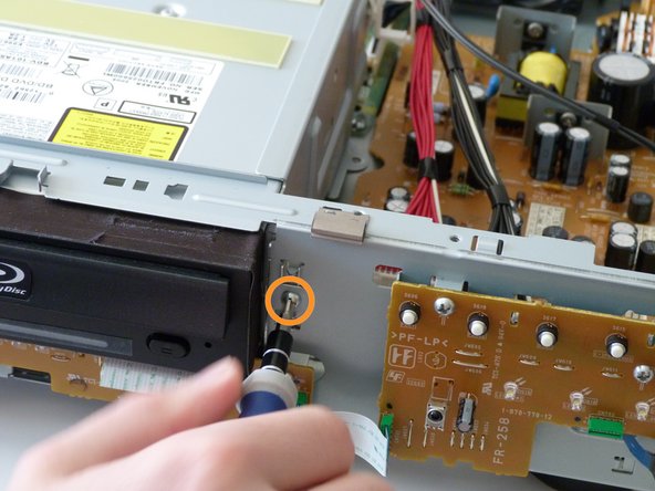

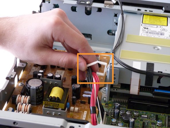

  6. Sony BDP-S1 Optical Drive Motor Replacement: crwdns2935265:06crwdnd2935265:01crwdnd2935265:02crwdne2935265:0 Sony BDP-S1 Optical Drive Motor Replacement: crwdns2935265:06crwdnd2935265:02crwdnd2935265:02crwdne2935265:0
    • Before unscrewing the optical drive enclosure, the small cable on the left of the drive (when looking at the device from the back) needs to be disconnected from the circuit board (the orange one).
    • Also, take the cables out of the white clip that is on the side of the optical drive.

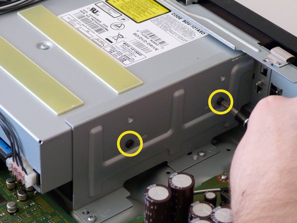

  7. Sony BDP-S1 Optical Drive Motor Replacement: crwdns2935265:07crwdnd2935265:01crwdnd2935265:03crwdne2935265:0 Sony BDP-S1 Optical Drive Motor Replacement: crwdns2935265:07crwdnd2935265:02crwdnd2935265:03crwdne2935265:0 Sony BDP-S1 Optical Drive Motor Replacement: crwdns2935265:07crwdnd2935265:03crwdnd2935265:03crwdne2935265:0
    • Unscrew the two metal clamps on both sides of the optical drive by removing three sets of screws:
    • The two 10mm silver screws on the bottom of the each clamp.
    • The 10mm silver screw holding each clamp from the front.
    • The two 5mm black screws on the sides.
    • Remove the two clamps. They can be removed by hand.

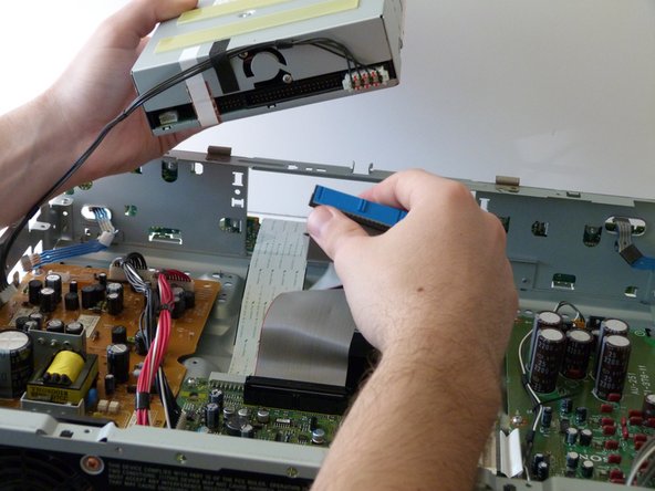

  8. Sony BDP-S1 Optical Drive Motor Replacement: crwdns2935265:08crwdnd2935265:01crwdnd2935265:03crwdne2935265:0 Sony BDP-S1 Optical Drive Motor Replacement: crwdns2935265:08crwdnd2935265:02crwdnd2935265:03crwdne2935265:0 Sony BDP-S1 Optical Drive Motor Replacement: crwdns2935265:08crwdnd2935265:03crwdnd2935265:03crwdne2935265:0
    • Gently pull the optical drive back to dislodge it from the front of the device and then lift it up.
    • Remove the wide ribbon cable from the back of the optical drive.

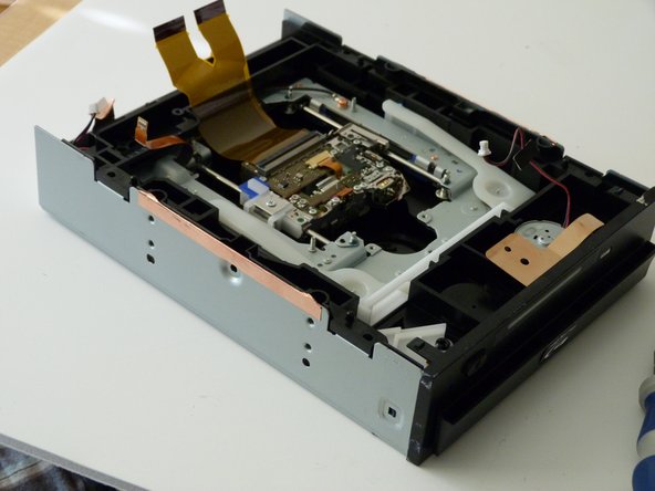

  10. Sony BDP-S1 Optical Drive Motor Replacement: crwdns2935265:010crwdnd2935265:01crwdnd2935265:03crwdne2935265:0 Sony BDP-S1 Optical Drive Motor Replacement: crwdns2935265:010crwdnd2935265:02crwdnd2935265:03crwdne2935265:0 Sony BDP-S1 Optical Drive Motor Replacement: crwdns2935265:010crwdnd2935265:03crwdnd2935265:03crwdne2935265:0

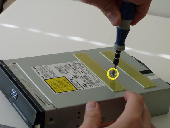

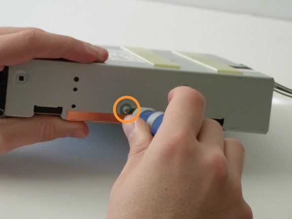

    • Remove the four 10mm silver screws on the bottom of the optical drive.
    • Remove the 10mm silver screw on each side of the optical drive.
    • Remove the single 6mm silver screw on the top of the optical drive.

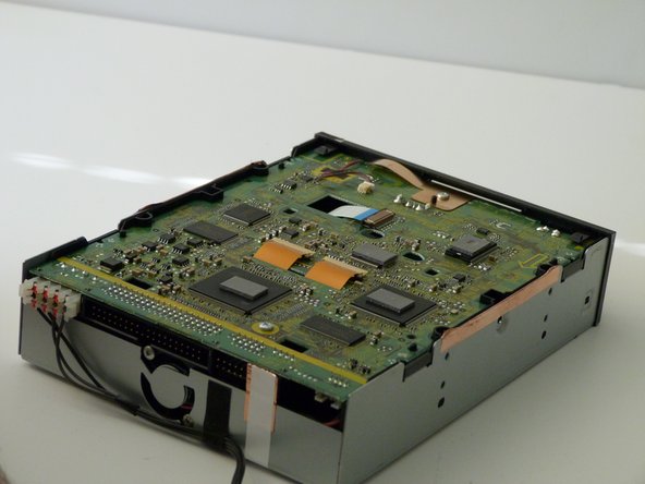

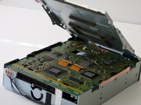

  11. Sony BDP-S1 Optical Drive Motor Replacement: crwdns2935265:011crwdnd2935265:01crwdnd2935265:03crwdne2935265:0 Sony BDP-S1 Optical Drive Motor Replacement: crwdns2935265:011crwdnd2935265:02crwdnd2935265:03crwdne2935265:0 Sony BDP-S1 Optical Drive Motor Replacement: crwdns2935265:011crwdnd2935265:03crwdnd2935265:03crwdne2935265:0
    • Any tape or foil strips need to be removed or cut before the drive can be opened (look at first image for example).
    • Pull off the bottom metal panel of the optical drive. You will see the main circuit board underneath.

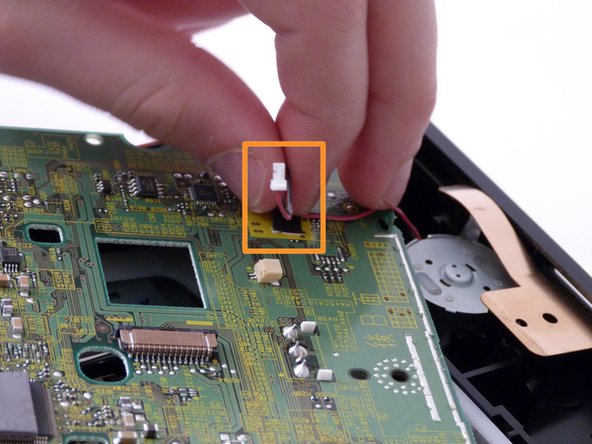

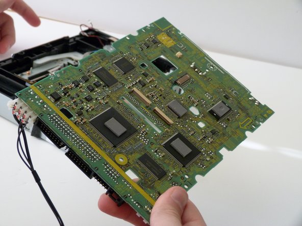

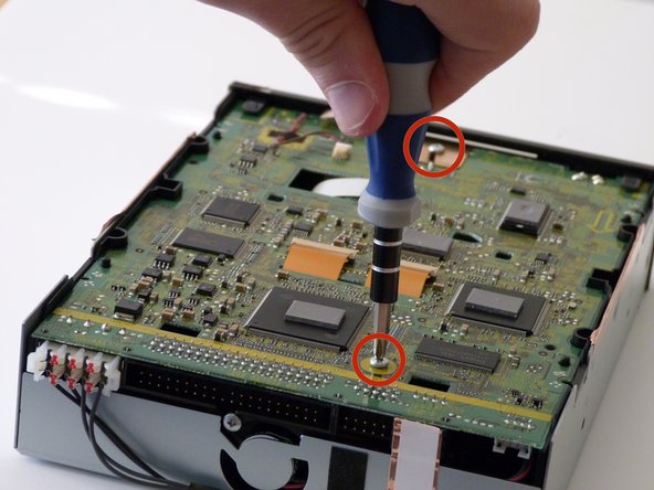

  12. Sony BDP-S1 Optical Drive Motor Replacement: crwdns2935265:012crwdnd2935265:01crwdnd2935265:03crwdne2935265:0 Sony BDP-S1 Optical Drive Motor Replacement: crwdns2935265:012crwdnd2935265:02crwdnd2935265:03crwdne2935265:0 Sony BDP-S1 Optical Drive Motor Replacement: crwdns2935265:012crwdnd2935265:03crwdnd2935265:03crwdne2935265:0
    • Remove the two, 20mm silver screws holding the circuit board in place.
    • Before removing the circuit board, you will need to disconnect the blue ribbon cable, two orange ribbon cables, and a small connector (look at second image for where the small connector is).
    • The orange ribbon cables are held in place by a small locking mechanism. Lift the small brown tabs for easy disconnection.
  13. Sony BDP-S1 Optical Drive Motor Replacement: crwdns2935265:013crwdnd2935265:01crwdnd2935265:02crwdne2935265:0 Sony BDP-S1 Optical Drive Motor Replacement: crwdns2935265:013crwdnd2935265:02crwdnd2935265:02crwdne2935265:0
    • Slowly lift up the circuit board. Make sure to disconnect the connector and ribbon cable on the underside of the circuit board before fulling removing it.

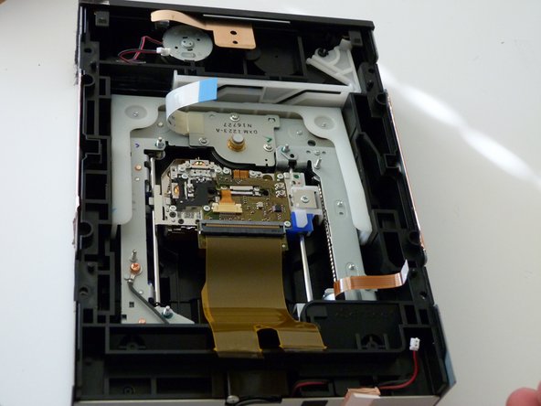

  14. Sony BDP-S1 Optical Drive Motor Replacement: crwdns2935265:014crwdnd2935265:01crwdnd2935265:02crwdne2935265:0 Sony BDP-S1 Optical Drive Motor Replacement: crwdns2935265:014crwdnd2935265:02crwdnd2935265:02crwdne2935265:0
    • Now you can see the inside of the optical drive. The motor is held in by three small 5mm silver screws. Remove them.
  15. Sony BDP-S1 Optical Drive Motor Replacement: crwdns2935265:015crwdnd2935265:01crwdnd2935265:02crwdne2935265:0 Sony BDP-S1 Optical Drive Motor Replacement: crwdns2935265:015crwdnd2935265:02crwdnd2935265:02crwdne2935265:0
    • Lift up the motor and replace it with a new one. Now you just need to put it back together!
