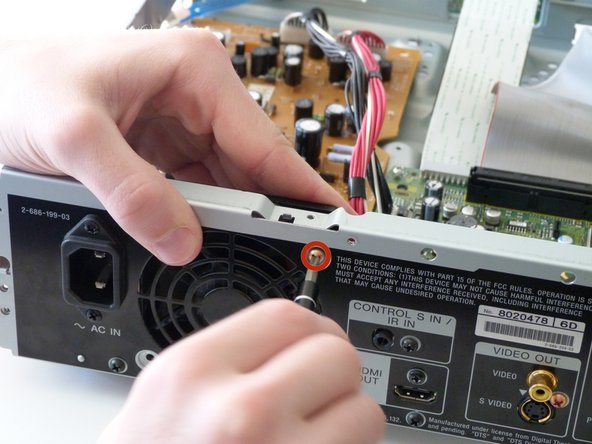

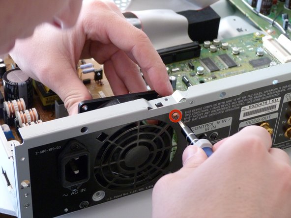

    1. Sony BDP-S1 Fan Replacement, Fan: crwdns2935265:05crwdnd2935265:01crwdnd2935265:03crwdne2935265:0 Sony BDP-S1 Fan Replacement, Fan: crwdns2935265:05crwdnd2935265:02crwdnd2935265:03crwdne2935265:0 Sony BDP-S1 Fan Replacement, Fan: crwdns2935265:05crwdnd2935265:03crwdnd2935265:03crwdne2935265:0
      • First we need to unscrew the fan from before we can remove it.
      • Remove both copper colored 10mm screws with a #2 phillips screwdriver.
      • As you remove the second screw, pull the fan inward to remove it from the remainder of the case. It should now only be connected to the case through a cable attached to the circuit board.
      • The disk drive is removed in the pictures, however this is not necessary to replace the fan and can be ignored.

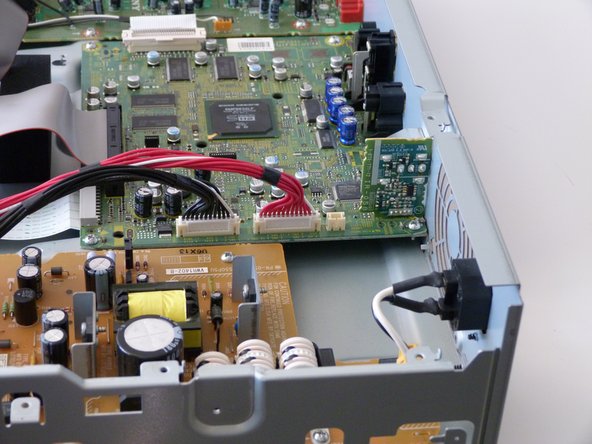

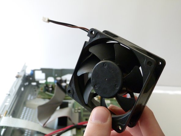

    2. Sony BDP-S1 Fan Replacement: crwdns2935265:06crwdnd2935265:01crwdnd2935265:03crwdne2935265:0 Sony BDP-S1 Fan Replacement: crwdns2935265:06crwdnd2935265:02crwdnd2935265:03crwdne2935265:0 Sony BDP-S1 Fan Replacement: crwdns2935265:06crwdnd2935265:03crwdnd2935265:03crwdne2935265:0
      • We will now completely remove the fan from the player.
      • Carefully detach the cable from the fan to the circuit board by pulling on the cable connecting the fan to the circuit board.
      • You are now ready to install the new fan!

We're can i get a replacement fan for my Blu- ray player model BDV-E4100. HEEEEELP PLEASE.
darren cottenham - crwdns2934203:0crwdne2934203:0 crwdns2950251:0crwdne2950251:0
@darrencottenham My Sony BDV-E2100 fan has the model number RDM4025S1 written on it. The models BDV-E3100, BDV-E4100, and BDV-E6100 use the same fan model. Maybe you can buy a defect unit to get the fan you are looking for.
