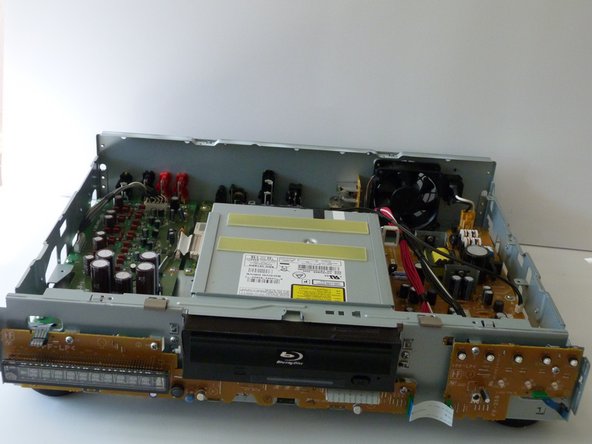

  4. Sony BDP-S1 Button Replacement: crwdns2935265:04crwdnd2935265:01crwdnd2935265:03crwdne2935265:0 Sony BDP-S1 Button Replacement: crwdns2935265:04crwdnd2935265:02crwdnd2935265:03crwdne2935265:0 Sony BDP-S1 Button Replacement: crwdns2935265:04crwdnd2935265:03crwdnd2935265:03crwdne2935265:0
    • After the top is off, you'll see that there are two metal bars that go across the top of the device.
    • Remove each bar by unscrewing the two 10mm silver screws on each end.

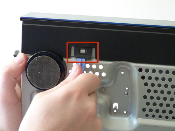

  5. Sony BDP-S1 Button Replacement, Front Panel Buttons: crwdns2935265:05crwdnd2935265:01crwdnd2935265:01crwdne2935265:0
    • Now, on the front panel, you will want to remove the two 10mm screws on top of the device.
  6. Sony BDP-S1 Button Replacement: crwdns2935265:06crwdnd2935265:01crwdnd2935265:03crwdne2935265:0 Sony BDP-S1 Button Replacement: crwdns2935265:06crwdnd2935265:02crwdnd2935265:03crwdne2935265:0 Sony BDP-S1 Button Replacement: crwdns2935265:06crwdnd2935265:03crwdnd2935265:03crwdne2935265:0

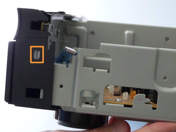

    • Place your blu-ray player so that it's facing the ceiling and support it with your non-dominant hand.
    • With your screwing hand, use the plastic opening tool to gently undo the three clips on the bottom of the device.
    • Then put the device back down and undo the two clips on the side.

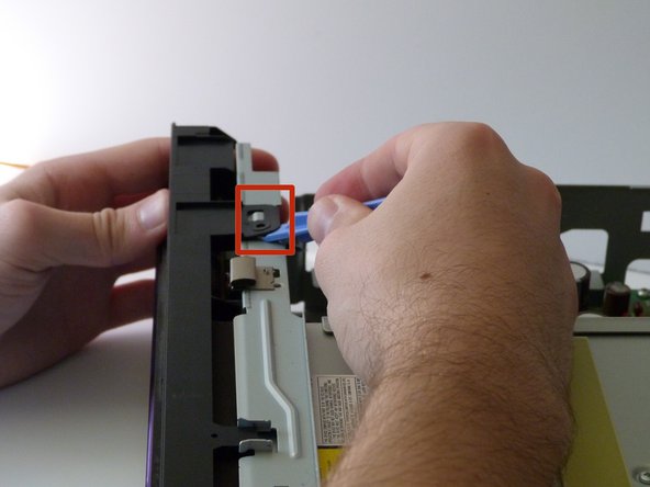

  7. Sony BDP-S1 Button Replacement: crwdns2935265:07crwdnd2935265:01crwdnd2935265:03crwdne2935265:0 Sony BDP-S1 Button Replacement: crwdns2935265:07crwdnd2935265:02crwdnd2935265:03crwdne2935265:0 Sony BDP-S1 Button Replacement: crwdns2935265:07crwdnd2935265:03crwdnd2935265:03crwdne2935265:0
    • On the top of the panel, use the plastic opening tool to unhook the top two clips.
    • Now the front should be detached so you can remove the front panel from the rest of the device.

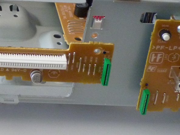

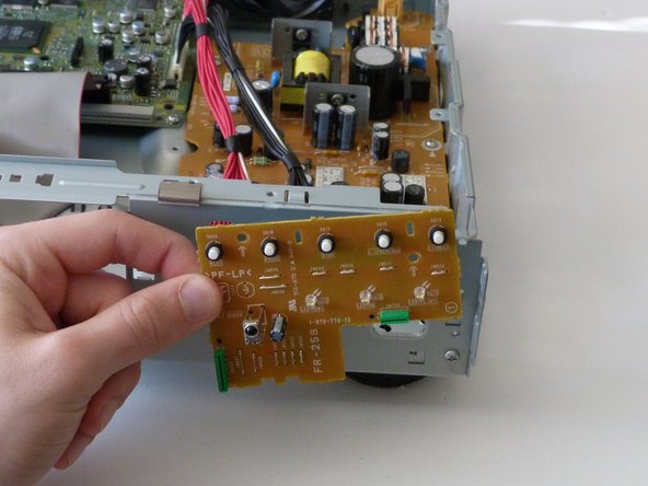

  8. Sony BDP-S1 Button Replacement: crwdns2935265:08crwdnd2935265:01crwdnd2935265:02crwdne2935265:0 Sony BDP-S1 Button Replacement: crwdns2935265:08crwdnd2935265:02crwdnd2935265:02crwdne2935265:0
    • Remove the ribbon cable found on the front panel by gently pulling at the base of the cable at each end.
    • NOTE: In these photos, the disk drive is removed. You don't have to remove the disk drive during this particular guide.

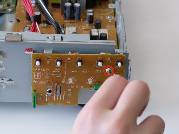

  9. Sony BDP-S1 Button Replacement: crwdns2935265:09crwdnd2935265:01crwdnd2935265:03crwdne2935265:0 Sony BDP-S1 Button Replacement: crwdns2935265:09crwdnd2935265:02crwdnd2935265:03crwdne2935265:0 Sony BDP-S1 Button Replacement: crwdns2935265:09crwdnd2935265:03crwdnd2935265:03crwdne2935265:0
    • Finally, remove the two 10mm screws on the front.
    • Congratulations! You have taken out the front panel!
