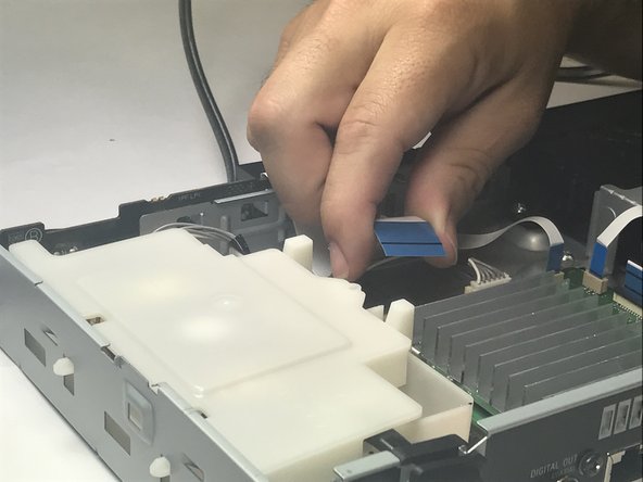

    • Now, spot the large ribbon cable that connects between the motherboard and the port board.
    • Remove the cable by pulling upwards.
    • Be careful when pulling upwards on the ribbon cable. Too much force can cause it to rip.
  5. Sony BDP-BX620 Port Board Replacement: crwdns2935265:05crwdnd2935265:01crwdnd2935265:01crwdne2935265:0
    • Use your Phillips screwdriver to take out the silver screw holding in the port board.
  6. Sony BDP-BX620 Port Board Replacement: crwdns2935265:06crwdnd2935265:01crwdnd2935265:01crwdne2935265:0
    • Now use the tweezers to unclip the portboard on the side.
