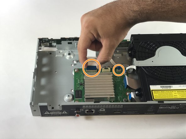

    • Remove the white ribbon cables connecting the motherboard to the display. The thick white ribbon cable in the middle needs the release button to be pressed down to allow it to come loose.

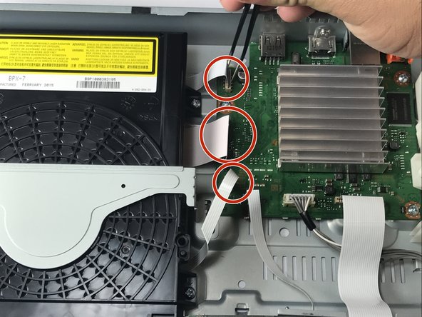

    • Remove the white ribbon cables connecting the motherboard to the disk drive. Be careful to not use too much force to not tear the cables.

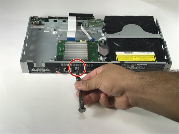

    • Once the ribbon cables are removed, remove the three screws holding the motherboard to the base of the player.
    • Finally remove the screw from the back of the player holding the motherboard in place.
