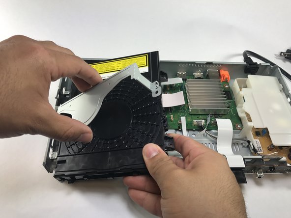

  4. Sony BDP-BX620 Disk Drive Replacement, Disk Drive: crwdns2935265:04crwdnd2935265:01crwdnd2935265:01crwdne2935265:0
    • Remove the no-fuss ribbon cable connectors by gently pulling on them.
    • Pulling harshly may break the flat cables.
  5. Sony BDP-BX620 Disk Drive Replacement: crwdns2935265:05crwdnd2935265:01crwdnd2935265:01crwdne2935265:0
    • Using the Phillips screw driver, remove the three screws.
  6. Sony BDP-BX620 Disk Drive Replacement: crwdns2935265:06crwdnd2935265:01crwdnd2935265:02crwdne2935265:0 Sony BDP-BX620 Disk Drive Replacement: crwdns2935265:06crwdnd2935265:02crwdnd2935265:02crwdne2935265:0
    • Turn the device over and use tweezers to push the metal clasp until it comes off.
    • Lift the metal brace located over the disk drive and remove the disk drive and the metal brace.
