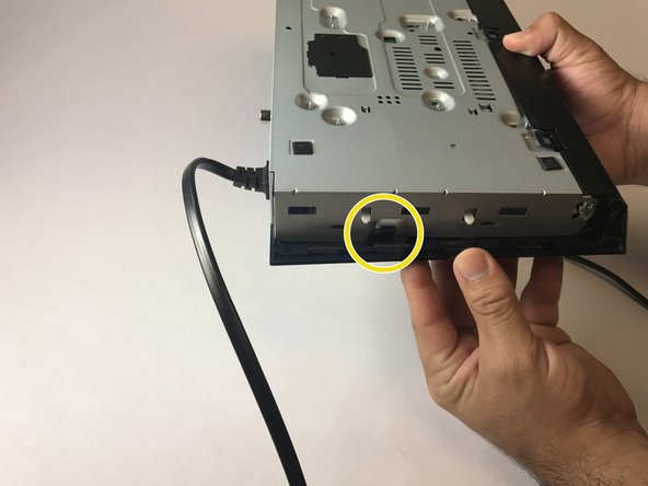

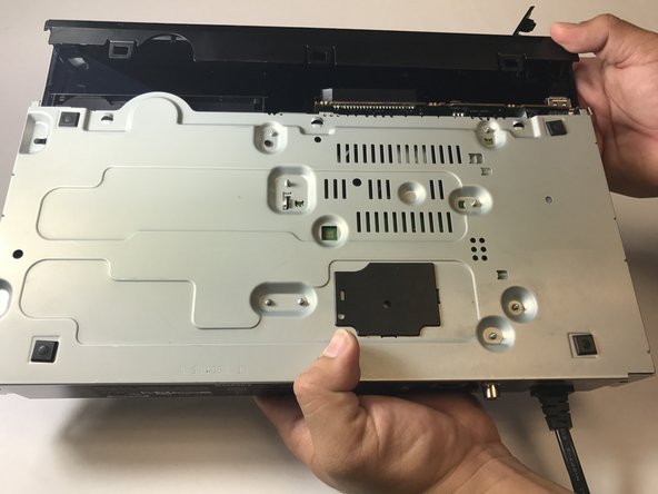

  3. Sony BDP-BX620 Cover Removal: crwdns2935265:03crwdnd2935265:01crwdnd2935265:03crwdne2935265:0 Sony BDP-BX620 Cover Removal: crwdns2935265:03crwdnd2935265:02crwdnd2935265:03crwdne2935265:0 Sony BDP-BX620 Cover Removal: crwdns2935265:03crwdnd2935265:03crwdnd2935265:03crwdne2935265:0
    • This step might require someone to help unclasping the plastic clips.
    • Turn the device so that the bottom is facing up.
    • In the bottom, unclip the three plastic clips circled in red.
    • On either side, unclip the plastic clip circled in red
    • Slide the black covering forwards to remove.
    • All five clips have to be unclasped for the covering to be removed.
    • Careful not to break the plastic clips when putting it back on.
