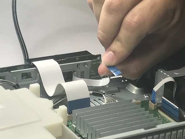

  7. Sony BDP-BX620 Bluetooth Module Replacement, Bluetooth Module: crwdns2935265:07crwdnd2935265:01crwdnd2935265:02crwdne2935265:0 Sony BDP-BX620 Bluetooth Module Replacement, Bluetooth Module: crwdns2935265:07crwdnd2935265:02crwdnd2935265:02crwdne2935265:0
    • Now, pull the small ribbon cable that connects between the motherboard and the Bluetooth module.
    • Be careful to not pull too hard or the ribbon cable will rip.
  8. Sony BDP-BX620 Bluetooth Module Replacement: crwdns2935265:08crwdnd2935265:01crwdnd2935265:01crwdne2935265:0
    • Use your Phillips screwdriver to remove the silver screw holding the Bluetooth module in place.
  9. Sony BDP-BX620 Bluetooth Module Replacement: crwdns2935265:09crwdnd2935265:01crwdnd2935265:01crwdne2935265:0
    • Lift to remove the bluetooth module from the device.
    • To prevent damage, always hold it on the sides.
