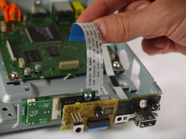

  8. Sony BDP-BX520 Port Board Replacement, Port Board: crwdns2935265:08crwdnd2935265:01crwdnd2935265:02crwdne2935265:0 Sony BDP-BX520 Port Board Replacement, Port Board: crwdns2935265:08crwdnd2935265:02crwdnd2935265:02crwdne2935265:0
    • When handling circuit boards like the motherboard and port board, make sure to only touch them on the sides.
    • Locate the large ribbon cable connecting the port board to the motherboard.
    • Detach the cable from the motherboard by carefully pulling upward on the cable.
  9. Sony BDP-BX520 Port Board Replacement: crwdns2935265:09crwdnd2935265:01crwdnd2935265:01crwdne2935265:0
    • Using the Phillips #2 screwdriver, unscrew the silver, 8mm screw holding the board in place.
  10. Sony BDP-BX520 Port Board Replacement: crwdns2935265:010crwdnd2935265:01crwdnd2935265:02crwdne2935265:0 Sony BDP-BX520 Port Board Replacement: crwdns2935265:010crwdnd2935265:02crwdnd2935265:02crwdne2935265:0
    • Using the nylon or metal spudger, carefully unclip the port board from the side of the player.
  11. Sony BDP-BX520 Port Board Replacement: crwdns2935265:011crwdnd2935265:01crwdnd2935265:01crwdne2935265:0
    • Carefully pull the port board free from the Blu-Ray player.
