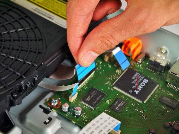

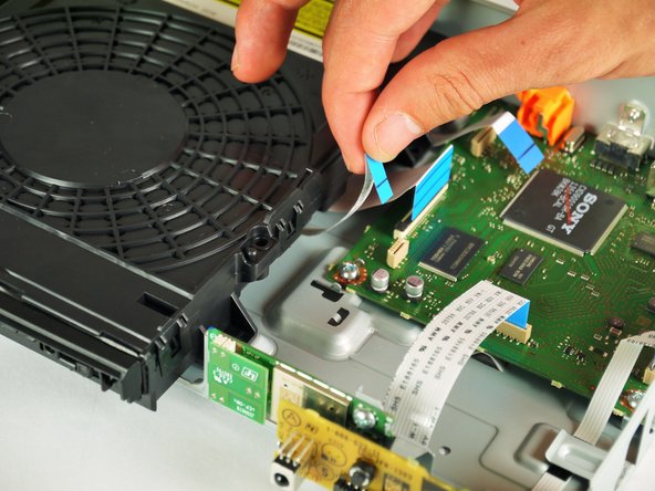

    • Remove the medium ribbon cable connecting the disc drive to the motherboard by lifting it out of its slot with your fingers.
    • It might take some force to lift the ribbon out, so be careful as to not damage the ribbon or the board.

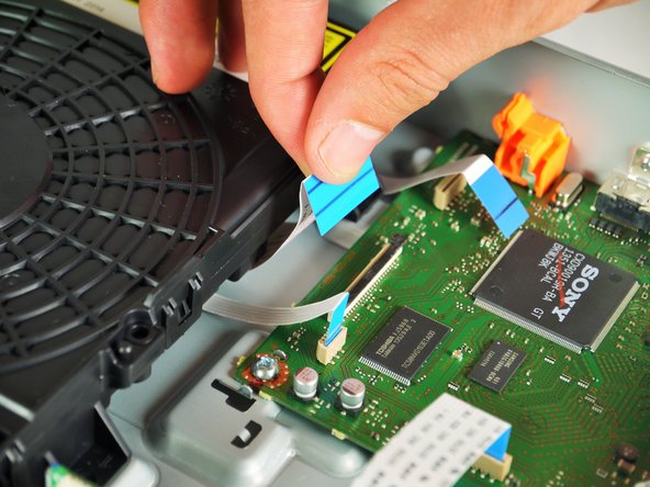

    • With the tweezers, remove the large ribbon cable by grabbing the black part of the connector and gently lifting up on each side.
    • Grab the ribbon with your hand and lift it out of the connector.

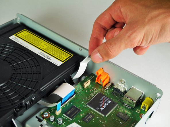

    • Grab the small ribbon cable and pull up to disconnect.
    • Like the medium ribbon cable, removing the small cable may require some force, so be careful as to not damage the cable or the motherboard.

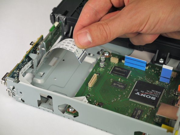

  13. Sony BDP-BX520 Motherboard Replacement: crwdns2935265:013crwdnd2935265:01crwdnd2935265:02crwdne2935265:0 Sony BDP-BX520 Motherboard Replacement: crwdns2935265:013crwdnd2935265:02crwdnd2935265:02crwdne2935265:0

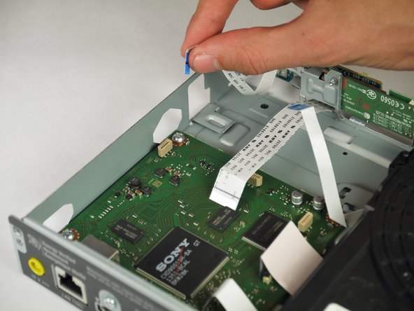

    • Remove the large, white ribbon cable connecting the motherboard to the port board (the larger of the two on the side nearest the front of the player) by lifting it out of its connector.
  14. Sony BDP-BX520 Motherboard Replacement: crwdns2935265:014crwdnd2935265:01crwdnd2935265:02crwdne2935265:0 Sony BDP-BX520 Motherboard Replacement: crwdns2935265:014crwdnd2935265:02crwdnd2935265:02crwdne2935265:0
    • Lift up the white ribbon cable connecting the Bluetooth board to the motherboard (the smaller of the two on the front side of the motherboard) to remove it.

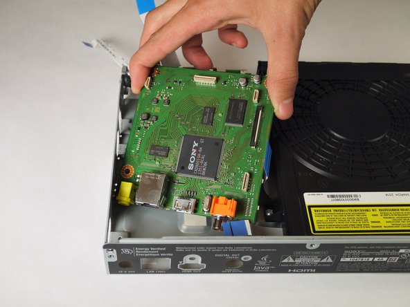

    • Remove the three screws holding the motherboard in the case.
  18. Sony BDP-BX520 Motherboard Replacement: crwdns2935265:018crwdnd2935265:01crwdnd2935265:02crwdne2935265:0 Sony BDP-BX520 Motherboard Replacement: crwdns2935265:018crwdnd2935265:02crwdnd2935265:02crwdne2935265:0
    • Hold the motherboard exclusively by its sides as to not short it out or damage it irreparably.
    • Slide the motherboard towards the front while lifting to remove.
