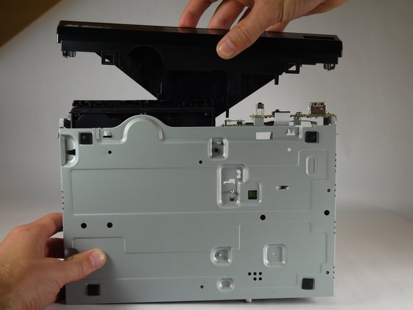

  9. Sony BDP-BX520 Disc Tray Replacement: crwdns2935265:09crwdnd2935265:01crwdnd2935265:02crwdne2935265:0 Sony BDP-BX520 Disc Tray Replacement: crwdns2935265:09crwdnd2935265:02crwdnd2935265:02crwdne2935265:0
    • Grasp the front case firmly and lift from the rest of the device.
    • Lifting may require some force.

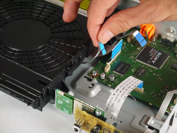

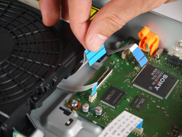

    • Pull the medium-sized 9 pin ribbon cable out of its connector on the motherboard.
  12. Sony BDP-BX520 Disc Tray Replacement: crwdns2935265:012crwdnd2935265:01crwdnd2935265:03crwdne2935265:0 Sony BDP-BX520 Disc Tray Replacement: crwdns2935265:012crwdnd2935265:02crwdnd2935265:03crwdne2935265:0 Sony BDP-BX520 Disc Tray Replacement: crwdns2935265:012crwdnd2935265:03crwdnd2935265:03crwdne2935265:0

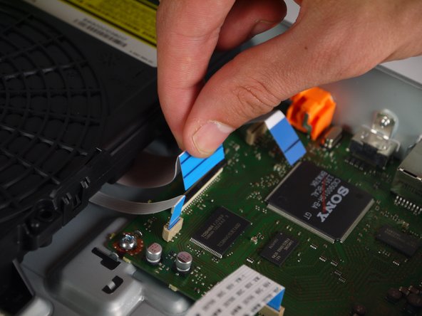

    • Using tweezers, lift up the tab of the large 45 pin connector on the motherboard.
    • Pull the large 45 pin ribbon cable out of its connector.

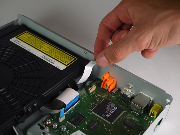

  13. Sony BDP-BX520 Disc Tray Replacement: crwdns2935265:013crwdnd2935265:01crwdnd2935265:02crwdne2935265:0 Sony BDP-BX520 Disc Tray Replacement: crwdns2935265:013crwdnd2935265:02crwdnd2935265:02crwdne2935265:0
    • Pull the small 5 pin ribbon cable out of its connector on the motherboard.

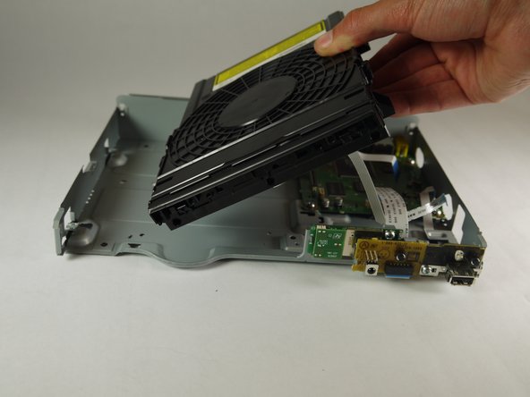

  14. Sony BDP-BX520 Disc Tray Replacement: crwdns2935265:014crwdnd2935265:01crwdnd2935265:02crwdne2935265:0 Sony BDP-BX520 Disc Tray Replacement: crwdns2935265:014crwdnd2935265:02crwdnd2935265:02crwdne2935265:0
    • Slide the disk tray out from under the tabs on the case holding it down while lifting it out of the case.
