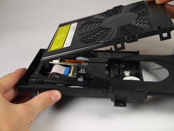

    4. Sony BDP-BX520 Disc Reader Replacement: crwdns2935265:013crwdnd2935265:01crwdnd2935265:02crwdne2935265:0 Sony BDP-BX520 Disc Reader Replacement: crwdns2935265:013crwdnd2935265:02crwdnd2935265:02crwdne2935265:0
      • Once the clips are free, lift the top cover of the disc tray up.
      • This should take minimal force.

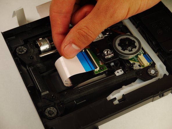

    5. Sony BDP-BX520 Disc Reader Replacement: crwdns2935265:014crwdnd2935265:01crwdnd2935265:01crwdne2935265:0
      • Unscrew the two silver 8mm Phillips 1 screws from the disc reader.

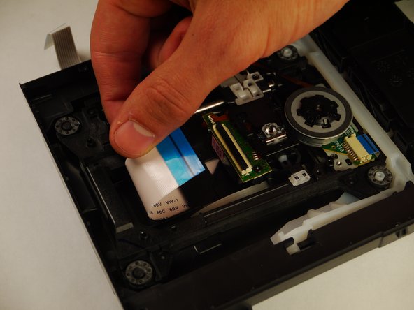

    6. Sony BDP-BX520 Disc Reader Replacement: crwdns2935265:015crwdnd2935265:01crwdnd2935265:03crwdne2935265:0 Sony BDP-BX520 Disc Reader Replacement: crwdns2935265:015crwdnd2935265:02crwdnd2935265:03crwdne2935265:0 Sony BDP-BX520 Disc Reader Replacement: crwdns2935265:015crwdnd2935265:03crwdnd2935265:03crwdne2935265:0
      • Use the tweezers to lift both sides of the black clip holding the white 14 pin ribbon in place.
      • Once free the white 24 pin ribbon should slip right out.

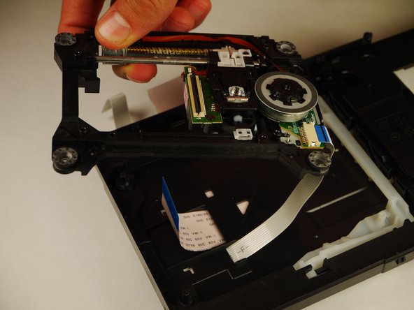

    7. Sony BDP-BX520 Disc Reader Replacement: crwdns2935265:016crwdnd2935265:01crwdnd2935265:02crwdne2935265:0 Sony BDP-BX520 Disc Reader Replacement: crwdns2935265:016crwdnd2935265:02crwdnd2935265:02crwdne2935265:0
      • Carefully lift up the disc reader. It is still attached by a cable underneath!

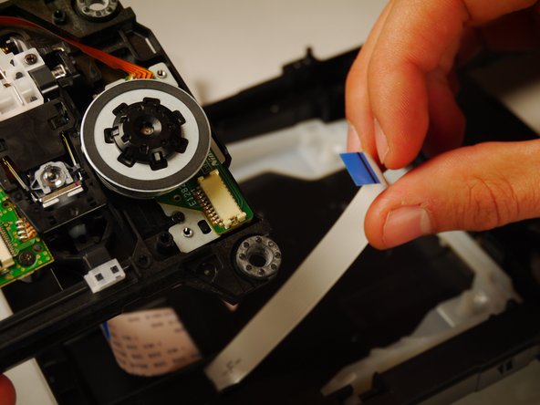

    8. Sony BDP-BX520 Disc Reader Replacement: crwdns2935265:017crwdnd2935265:01crwdnd2935265:02crwdne2935265:0 Sony BDP-BX520 Disc Reader Replacement: crwdns2935265:017crwdnd2935265:02crwdnd2935265:02crwdne2935265:0
      • Gently pull out the white 13 pin cable from the disc reader.
