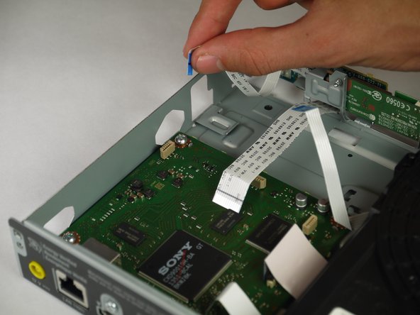

    • When handling circuit boards like the motherboard and port board, make sure to only touch them on the sides.
    • Locate the large ribbon cable connecting the port board to the motherboard.
    • Detach the cable from the motherboard by carefully pulling upward on the cable.

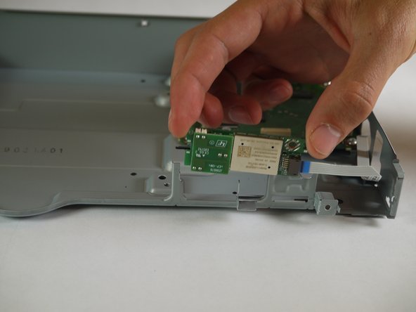

  14. Sony BDP-BX520 Bluetooth Module Replacement, Bluetooth Module: crwdns2935265:014crwdnd2935265:01crwdnd2935265:02crwdne2935265:0 Sony BDP-BX520 Bluetooth Module Replacement, Bluetooth Module: crwdns2935265:014crwdnd2935265:02crwdnd2935265:02crwdne2935265:0
    • Pull the small 5 pin ribbon cable out of its connector on the motherboard.
  15. Sony BDP-BX520 Bluetooth Module Replacement: crwdns2935265:015crwdnd2935265:01crwdnd2935265:01crwdne2935265:0
    • Using a Phillips #2 screwdriver, remove the silver 8 mm screw attaching the Bluetooth module to the front of the case.
  16. Sony BDP-BX520 Bluetooth Module Replacement: crwdns2935265:016crwdnd2935265:01crwdnd2935265:02crwdne2935265:0 Sony BDP-BX520 Bluetooth Module Replacement: crwdns2935265:016crwdnd2935265:02crwdnd2935265:02crwdne2935265:0
    • Remove the Bluetooth module from the case.
    • Make sure to only touch the sides of the Bluetooth module when removing it from the case.
