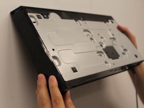

      • Turn to the back of the device.
      • Remove the two 7mm Phillips #2 screws.
      • Slide the two plastic covers on both sides of the device towards the back of the device to remove them.

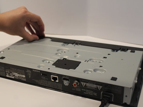

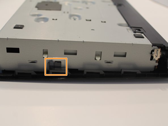

      • Turn the device so you can see the bottom.
      • Unclip the three black plastic clips on the bottom of the device.
      • Unclip one clip on each side of the device.
