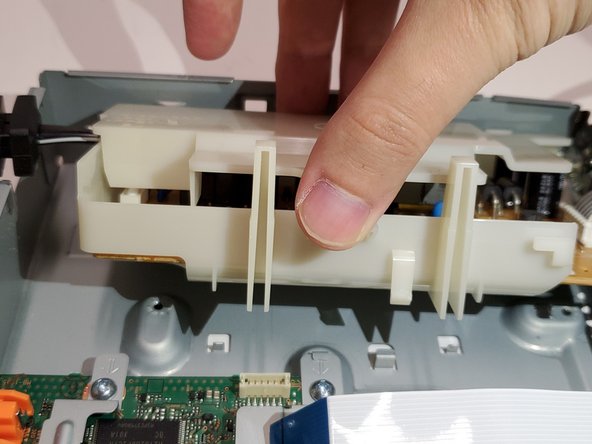

    • Remove the two 5mm Phillips #1 screws.
    • Lift the side of the power module and remove it.

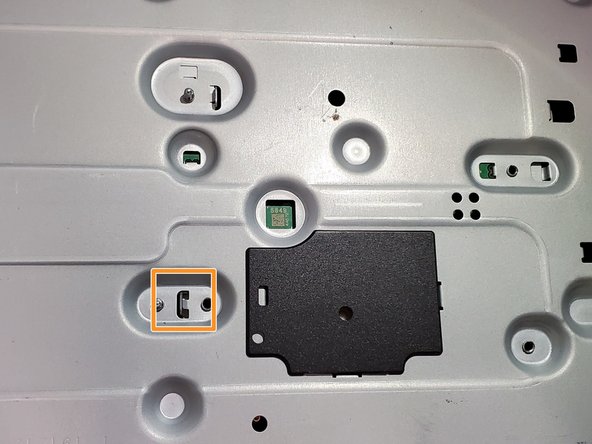

    • Use tweezers or metal spudger to take off the metal clasp for the metal brace near the center on the bottom of the device.
    • Remove the metal brace.

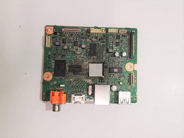

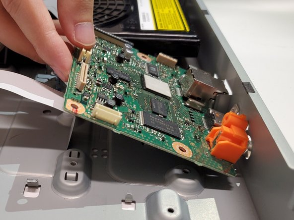

  10. Sony BDP-BX510 Motherboard Replacement: crwdns2935265:010crwdnd2935265:01crwdnd2935265:03crwdne2935265:0 Sony BDP-BX510 Motherboard Replacement: crwdns2935265:010crwdnd2935265:02crwdnd2935265:03crwdne2935265:0 Sony BDP-BX510 Motherboard Replacement: crwdns2935265:010crwdnd2935265:03crwdnd2935265:03crwdne2935265:0
    • Turn to the back of the device.
    • Remove the silver 3mm Phillips #1 screw.
    • Remove the black 7mm Phillips #1 screw.
    • Lift the side of the motherboard and pull it out.
