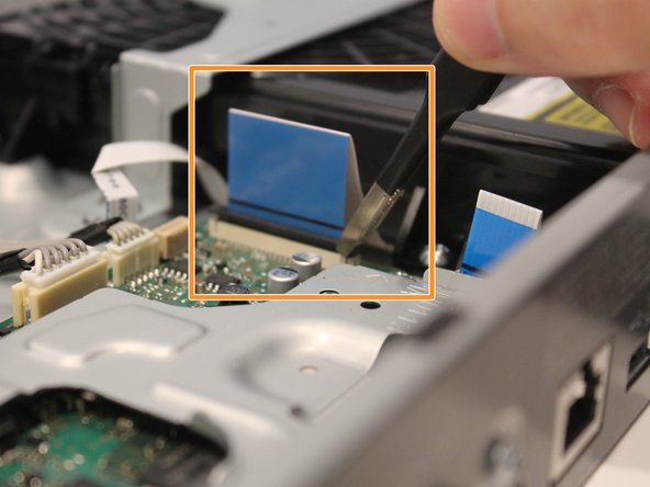

  6. Sony BDP-BX510 Disk Tray Replacement, Disk Tray: crwdns2935265:06crwdnd2935265:01crwdnd2935265:02crwdne2935265:0 Sony BDP-BX510 Disk Tray Replacement, Disk Tray: crwdns2935265:06crwdnd2935265:02crwdnd2935265:02crwdne2935265:0
    • Pull the medium-sized 9 pin ribbon cable and the small 5 pin ribbon cable out of their connector in the motherboard.
    • Using tweezers, lift the black tab on the connector of the large 45 pin connector on the motherboard.
    • Pull the large 45 pin ribbon cable out of the connector in the motherboard.
    • Be very careful. The goal is to slightly lift the pin connector, not to completely detach it. Do not forcibly pull.

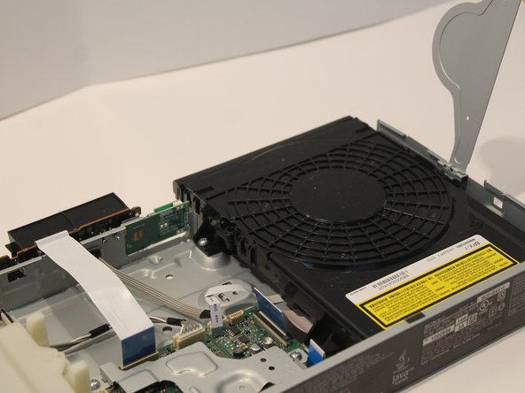

  7. Sony BDP-BX510 Disk Tray Replacement: crwdns2935265:07crwdnd2935265:01crwdnd2935265:01crwdne2935265:0
    • Remove the 5mm Phillips #2 screw holding the metal brace above the disk tray.
    • Remove the two 5mm Phillips #2 screws that hold the disk tray to the metal case on the bottom.

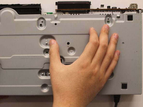

  8. Sony BDP-BX510 Disk Tray Replacement: crwdns2935265:08crwdnd2935265:01crwdnd2935265:03crwdne2935265:0 Sony BDP-BX510 Disk Tray Replacement: crwdns2935265:08crwdnd2935265:02crwdnd2935265:03crwdne2935265:0 Sony BDP-BX510 Disk Tray Replacement: crwdns2935265:08crwdnd2935265:03crwdnd2935265:03crwdne2935265:0
    • Turn the device over to the backside.
    • Use tweezers or hands to take off the metal clasp for the metal brace near the center on the bottom of the device.
  9. Sony BDP-BX510 Disk Tray Replacement: crwdns2935265:09crwdnd2935265:01crwdnd2935265:01crwdne2935265:0
    • Remove the metal brace then remove the disk tray.
