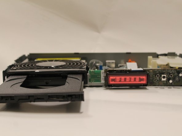

    • Plug in the device to turn it on, then press the eject ( ⏏ ) button to open the tray.
  2. Sony BDP-BX510 Disk Reader Replacement: crwdns2935265:02crwdnd2935265:01crwdnd2935265:02crwdne2935265:0 Sony BDP-BX510 Disk Reader Replacement: crwdns2935265:02crwdnd2935265:02crwdnd2935265:02crwdne2935265:0
    • To remove the tray cover, hold both sides of the tray cover and gently apply a downward pressure.
    • Apply slightly more pressure to the left side until it unhooks then unhook the right side.
    • Close the disk tray by pressing the eject button again, then power off the device and unplug it.
    • Do not use too much force to remove the tray cover as you may break it.

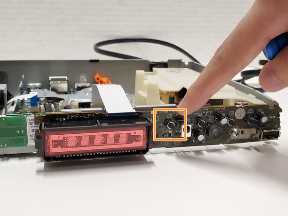

    • Pull the medium-sized 9 pin ribbon cable and the small 5 pin ribbon cable out of their connector in the motherboard.
    • Using tweezers, lift the black tab on the connector of the large 45 pin connector on the motherboard.
    • Pull the large 45 pin ribbon cable out of the connector in the motherboard.
    • Be very careful. The goal is to slightly lift the pin connector, not to completely detach it. Do not forcibly pull.

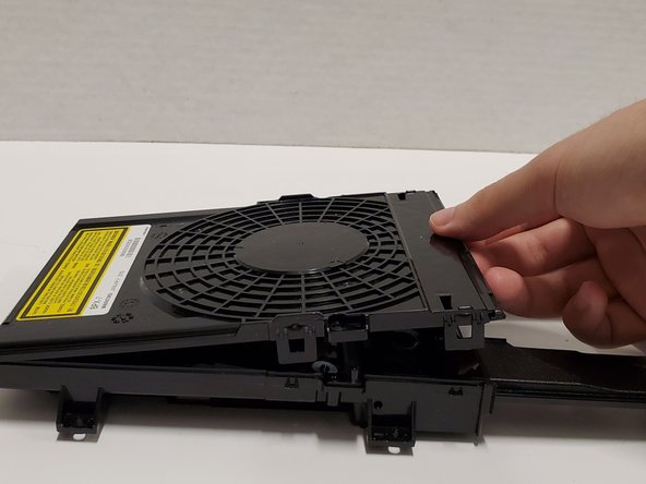

  7. Sony BDP-BX510 Disk Reader Replacement: crwdns2935265:07crwdnd2935265:01crwdnd2935265:01crwdne2935265:0
    • Remove the 5mm Phillips #2 screw holding the metal brace above the disk tray.
    • Remove the two 5mm Phillips #2 screws that hold the disk tray to the metal case on the bottom.
  8. Sony BDP-BX510 Disk Reader Replacement: crwdns2935265:08crwdnd2935265:01crwdnd2935265:03crwdne2935265:0 Sony BDP-BX510 Disk Reader Replacement: crwdns2935265:08crwdnd2935265:02crwdnd2935265:03crwdne2935265:0 Sony BDP-BX510 Disk Reader Replacement: crwdns2935265:08crwdnd2935265:03crwdnd2935265:03crwdne2935265:0
    • Turn the device over to the backside.
    • Use tweezers or hands to take off the metal clasp for the metal brace near the center on the bottom of the device.
  9. Sony BDP-BX510 Disk Reader Replacement: crwdns2935265:09crwdnd2935265:01crwdnd2935265:01crwdne2935265:0
    • Remove the metal brace then remove the disk tray.

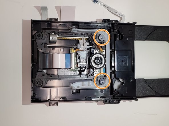

  11. Sony BDP-BX510 Disk Reader Replacement: crwdns2935265:011crwdnd2935265:01crwdnd2935265:03crwdne2935265:0 Sony BDP-BX510 Disk Reader Replacement: crwdns2935265:011crwdnd2935265:02crwdnd2935265:03crwdne2935265:0 Sony BDP-BX510 Disk Reader Replacement: crwdns2935265:011crwdnd2935265:03crwdnd2935265:03crwdne2935265:0
    • Locate and unclip the plastic clips on the sides of the disk tray using a metal spudger. There are two on each side of the disk tray.
    • Lift open and remove the top cover of the disk tray.
    • Remove the two 6mm Phillips #0 screws from the disk reader.

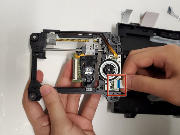

  12. Sony BDP-BX510 Disk Reader Replacement: crwdns2935265:012crwdnd2935265:01crwdnd2935265:01crwdne2935265:0
    • Using tweezers, lift the black tab on the connector of the large ribbon cable on the disk reader.
    • Pull the large ribbon cable out of the connector in the disk reader.
    • Do not forcibly pull out the large ribbon cable as you could damage it. Once the black tab is lifted it should come out easily.

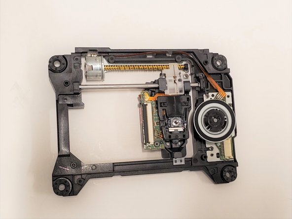

  13. Sony BDP-BX510 Disk Reader Replacement: crwdns2935265:013crwdnd2935265:01crwdnd2935265:03crwdne2935265:0 Sony BDP-BX510 Disk Reader Replacement: crwdns2935265:013crwdnd2935265:02crwdnd2935265:03crwdne2935265:0 Sony BDP-BX510 Disk Reader Replacement: crwdns2935265:013crwdnd2935265:03crwdnd2935265:03crwdne2935265:0
    • Lift the disk reader carefully.
    • Do not lift the disk reader roughly as there is small cable attached to it.
    • Pull the small ribbon cable out of the disk reader.
