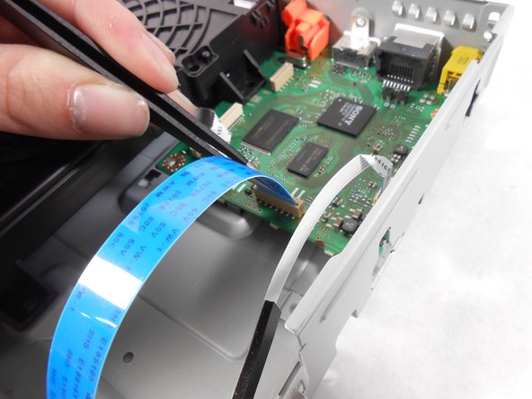

    • Do not bend or tear the ribbon cable.

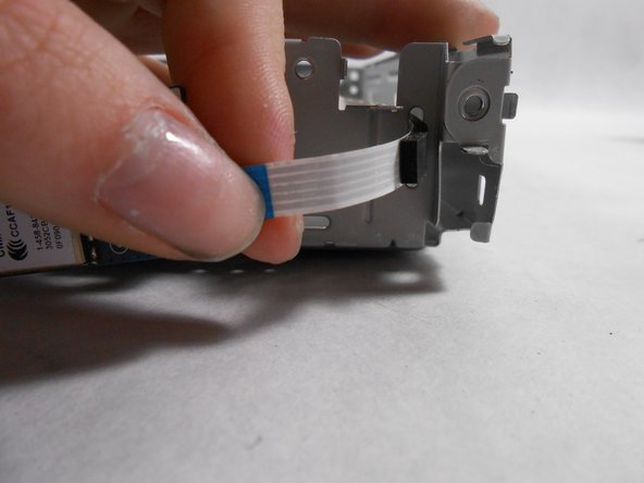

    • Using the plastic tweezers, carefully remove the ribbon cable from the motherboard.
  6. Sony BDP BX350 Wifi Card Replacement: crwdns2935265:06crwdnd2935265:01crwdnd2935265:01crwdne2935265:0
    • Unscrew the one 5mm Phillips head screw from the front of the device board.
  7. Sony BDP BX350 Wifi Card Replacement: crwdns2935265:07crwdnd2935265:01crwdnd2935265:02crwdne2935265:0 Sony BDP BX350 Wifi Card Replacement: crwdns2935265:07crwdnd2935265:02crwdnd2935265:02crwdne2935265:0
    • Do not bend or tear ribbon cable.
    • Carefully separate the device control board from the metal casing.

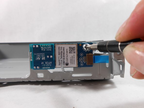

  8. Sony BDP BX350 Wifi Card Replacement, Wifi Card: crwdns2935265:08crwdnd2935265:01crwdnd2935265:02crwdne2935265:0 Sony BDP BX350 Wifi Card Replacement, Wifi Card: crwdns2935265:08crwdnd2935265:02crwdnd2935265:02crwdne2935265:0
    • Remove 6mm Philips head screw from wifi board.

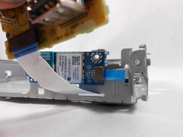

  9. Sony BDP BX350 Wifi Card Replacement: crwdns2935265:09crwdnd2935265:01crwdnd2935265:01crwdne2935265:0
    • Remove the ribbon cable from motherboard using a pair of tweezers.
  10. Sony BDP BX350 Wifi Card Replacement: crwdns2935265:010crwdnd2935265:01crwdnd2935265:03crwdne2935265:0 Sony BDP BX350 Wifi Card Replacement: crwdns2935265:010crwdnd2935265:02crwdnd2935265:03crwdne2935265:0 Sony BDP BX350 Wifi Card Replacement: crwdns2935265:010crwdnd2935265:03crwdnd2935265:03crwdne2935265:0
    • Carefully remove board and ribbon cables by pulling upwards then out to free it from the metal clips.
