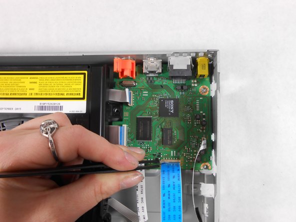

  8. Sony BDP BX350 Motherboard Replacement, Motherboard: crwdns2935265:08crwdnd2935265:01crwdnd2935265:02crwdne2935265:0 Sony BDP BX350 Motherboard Replacement, Motherboard: crwdns2935265:08crwdnd2935265:02crwdnd2935265:02crwdne2935265:0
    • Do not bend or tear the ribbon cable.
    • Remove all five ribbon cables from the motherboard.
