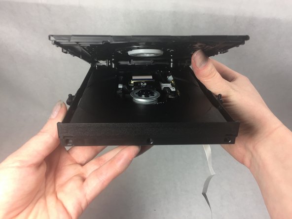

  8. Sony BDP BX350 Disc Tray Replacement, Disc Tray: crwdns2935265:08crwdnd2935265:01crwdnd2935265:01crwdne2935265:0
    • Take caution to not break plastic tabs.
    • Undo the four tabs on the disc tray assembly.
  9. Sony BDP BX350 Disc Tray Replacement: crwdns2935265:09crwdnd2935265:01crwdnd2935265:02crwdne2935265:0 Sony BDP BX350 Disc Tray Replacement: crwdns2935265:09crwdnd2935265:02crwdnd2935265:02crwdne2935265:0
    • Lift front until back separates.
  10. Sony BDP BX350 Disc Tray Replacement: crwdns2935265:010crwdnd2935265:01crwdnd2935265:01crwdne2935265:0
    • Remove disc from disc tray.
To reassemble your device, follow these instructions in reverse order however do not put the disc back in.
