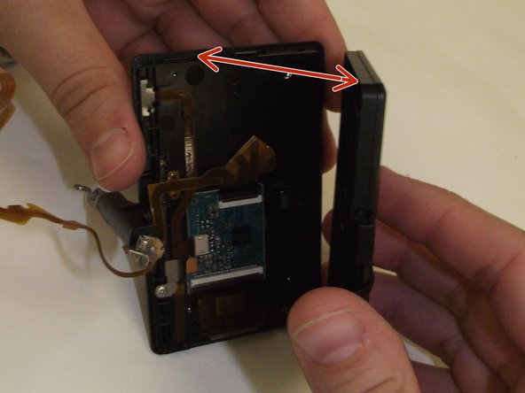

  12. Sony Alpha SLT-A55V LCD Display Replacement: crwdns2935265:012crwdnd2935265:01crwdnd2935265:02crwdne2935265:0 Sony Alpha SLT-A55V LCD Display Replacement: crwdns2935265:012crwdnd2935265:02crwdnd2935265:02crwdne2935265:0
    • Using a nylon spudger, separate the LCD case the same way the main housing was separated.
  13. Sony Alpha SLT-A55V LCD Display Replacement: crwdns2935265:013crwdnd2935265:01crwdnd2935265:01crwdne2935265:0
    • Unplug the ribbon cable from the LCD screen.
    • Replace the LCD screen and re-assemble in reverse order of these steps.
