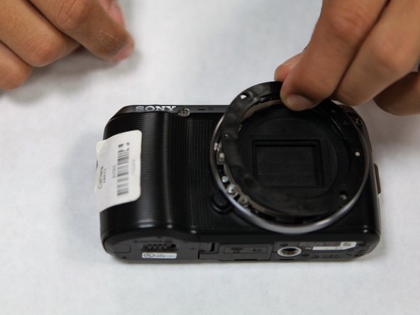

      • Turn the camera off by sliding the power switch.
    2. Sony Alpha NEX-C3 Lens Mount Replacement: crwdns2935265:02crwdnd2935265:01crwdnd2935265:01crwdne2935265:0
      • Use a Phillips head 000 screwdriver to remove the four 5.0mm screws on the E-mount.
    3. Sony Alpha NEX-C3 Lens Mount Replacement: crwdns2935265:03crwdnd2935265:01crwdnd2935265:03crwdne2935265:0 Sony Alpha NEX-C3 Lens Mount Replacement: crwdns2935265:03crwdnd2935265:02crwdnd2935265:03crwdne2935265:0 Sony Alpha NEX-C3 Lens Mount Replacement: crwdns2935265:03crwdnd2935265:03crwdnd2935265:03crwdne2935265:0

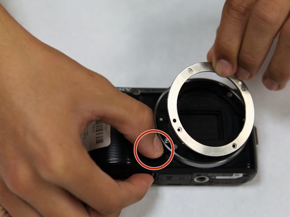

      • Press on the lens mount button with one hand.
      • With the other hand, grab and gently wiggle off the E-mount metal ring until its free.
      • Remove the plastic ring located under the metal ring.
      • Do not remove the thin metal piece behind the plastic ring.
