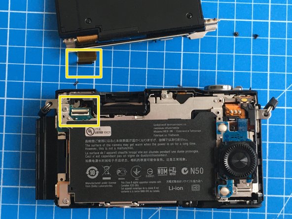

  6. Sony Alpha NEX-3N Disassembly and Shutter Repair: crwdns2935265:06crwdnd2935265:01crwdnd2935265:02crwdne2935265:0 Sony Alpha NEX-3N Disassembly and Shutter Repair: crwdns2935265:06crwdnd2935265:02crwdnd2935265:02crwdne2935265:0
    • Free the LCD unit by removing two small black metric screws using Philips #00 screwdriver.
    • Gently unlock the ZIF connector as marked to remove the flat flex cable.

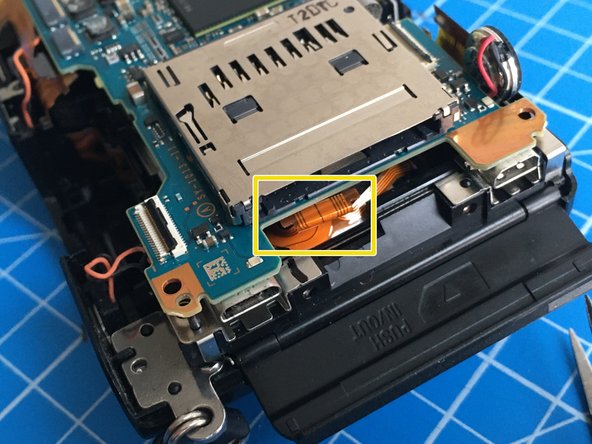

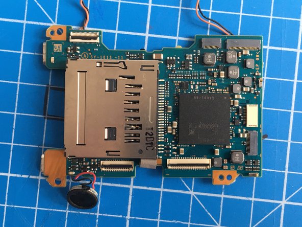

  13. Sony Alpha NEX-3N Disassembly and Shutter Repair: crwdns2935265:013crwdnd2935265:01crwdnd2935265:03crwdne2935265:0 Sony Alpha NEX-3N Disassembly and Shutter Repair: crwdns2935265:013crwdnd2935265:02crwdnd2935265:03crwdne2935265:0 Sony Alpha NEX-3N Disassembly and Shutter Repair: crwdns2935265:013crwdnd2935265:03crwdnd2935265:03crwdne2935265:0
    • The mainboard has 8 flat flex cables connected to it. 2 of them are hidden behind.
    • One of the flex cables may have high voltage from the flash charge circuit, so be careful when touching around. The flex cable is at the back of the unit, in the area marked with red circle in the first photo.
    • The bottom two flat flex cables have ZIF connectors with locking tabs. The rest are pressure fit, just pull them away gently using tweezers.
  14. Sony Alpha NEX-3N Disassembly and Shutter Repair: crwdns2935265:014crwdnd2935265:01crwdnd2935265:02crwdne2935265:0 Sony Alpha NEX-3N Disassembly and Shutter Repair: crwdns2935265:014crwdnd2935265:02crwdnd2935265:02crwdne2935265:0
    • Remove all the flat flex cables carefully by pulling them.
  15. Sony Alpha NEX-3N Disassembly and Shutter Repair: crwdns2935265:015crwdnd2935265:01crwdnd2935265:03crwdne2935265:0 Sony Alpha NEX-3N Disassembly and Shutter Repair: crwdns2935265:015crwdnd2935265:02crwdnd2935265:03crwdne2935265:0 Sony Alpha NEX-3N Disassembly and Shutter Repair: crwdns2935265:015crwdnd2935265:03crwdnd2935265:03crwdne2935265:0
    • When removing the mainboard, be careful not to rip the microphone and speaker cables off.
    • Be careful with the high voltage flash circuitry as shown with the red circle in the first photo.
