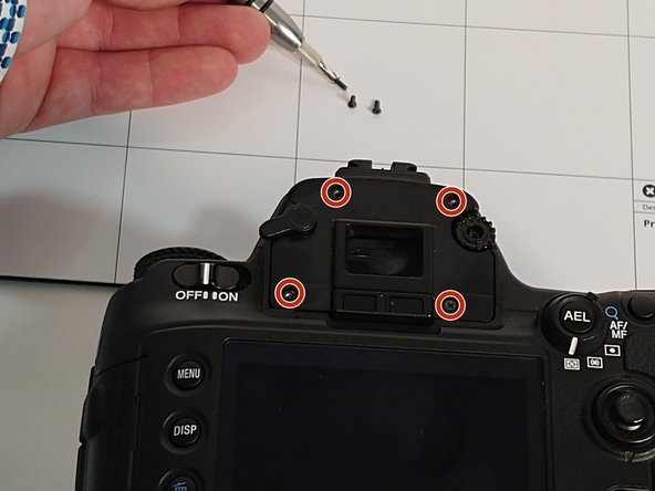

    • Find the rubber viewfinder cover on the upper rear of the camera, above the view screen.
  2. Sony Alpha DSLR- A850 Viewfinder Window Replacement: crwdns2935265:02crwdnd2935265:01crwdnd2935265:01crwdne2935265:0
    • Slide the rubber piece off.
    • There may be a slight popping sound.
  3. Sony Alpha DSLR- A850 Viewfinder Window Replacement: crwdns2935265:03crwdnd2935265:01crwdnd2935265:01crwdne2935265:0
    • Once the rubber piece has been removed, inspect the area.
    • If everything looks fine, go ahead and slide the new rubber piece on the same way the old piece was slipped off.
  4. Sony Alpha DSLR- A850 Viewfinder Window Replacement, Viewfinder Window: crwdns2935265:04crwdnd2935265:01crwdnd2935265:02crwdne2935265:0 Sony Alpha DSLR- A850 Viewfinder Window Replacement, Viewfinder Window: crwdns2935265:04crwdnd2935265:02crwdnd2935265:02crwdne2935265:0
    • Remove all four screws from the viewfinder.
  5. Sony Alpha DSLR- A850 Viewfinder Window Replacement: crwdns2935265:05crwdnd2935265:01crwdnd2935265:02crwdne2935265:0 Sony Alpha DSLR- A850 Viewfinder Window Replacement: crwdns2935265:05crwdnd2935265:02crwdnd2935265:02crwdne2935265:0
    • Grasp the side of the window with either a set of tweezers or your fingers. Lift upwards and slightly towards the base of the camera.
  6. Sony Alpha DSLR- A850 Viewfinder Window Replacement: crwdns2935265:06crwdnd2935265:01crwdnd2935265:01crwdne2935265:0
    • To reinsert the window, push inward and slightly forward. There is a tab on the camera that the window must catch on in order to be put into place.
