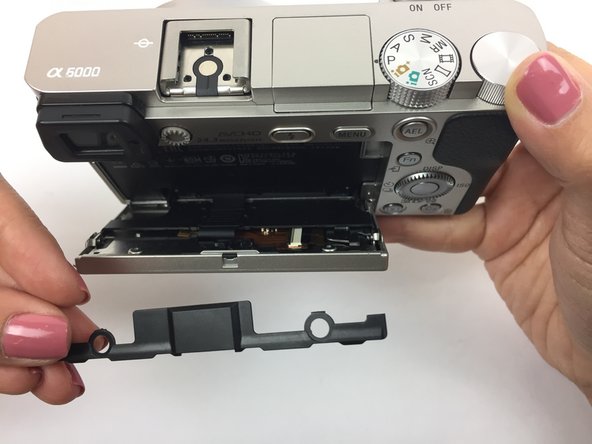

    2. Sony Alpha 6000 Screen Replacement: crwdns2935265:07crwdnd2935265:01crwdnd2935265:03crwdne2935265:0 Sony Alpha 6000 Screen Replacement: crwdns2935265:07crwdnd2935265:02crwdnd2935265:03crwdne2935265:0 Sony Alpha 6000 Screen Replacement: crwdns2935265:07crwdnd2935265:03crwdnd2935265:03crwdne2935265:0
      • Flip the screen so it is facing up and then have the bottom of the camera facing yourself.
      • Using a spudger, remove the larger back panel.
      • Flip the camera right side up and pull back the screen.
      • Remove the smaller black panel on the back of the screen.

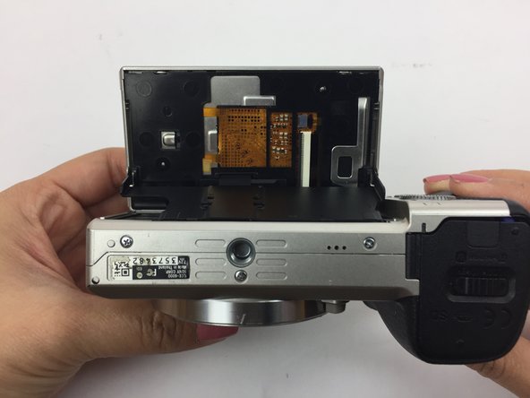

    4. Sony Alpha 6000 Screen Replacement: crwdns2935265:09crwdnd2935265:01crwdnd2935265:03crwdne2935265:0 Sony Alpha 6000 Screen Replacement: crwdns2935265:09crwdnd2935265:02crwdnd2935265:03crwdne2935265:0 Sony Alpha 6000 Screen Replacement: crwdns2935265:09crwdnd2935265:03crwdnd2935265:03crwdne2935265:0
      • Flip the screen back so it is facing up and then have the bottom of the camera facing you. The yellow circuit board should now be exposed.
      • Hold down the yellow circuit board that the ribbon cables are attached to.
      • Using tweezers, remove the smaller ribbon cable. This may require extra force that could damage the ribbon cable.

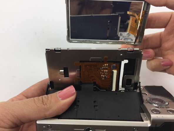

    5. Sony Alpha 6000 Screen Replacement: crwdns2935265:010crwdnd2935265:01crwdnd2935265:02crwdne2935265:0 Sony Alpha 6000 Screen Replacement: crwdns2935265:010crwdnd2935265:02crwdnd2935265:02crwdne2935265:0
      • Remove the larger ribbon cable. This may require extra force that could damage the ribbon cable.
    6. Sony Alpha 6000 Screen Replacement: crwdns2935265:011crwdnd2935265:01crwdnd2935265:02crwdne2935265:0 Sony Alpha 6000 Screen Replacement: crwdns2935265:011crwdnd2935265:02crwdnd2935265:02crwdne2935265:0
      • Using a plastic opening tool, separate the silver panel from the actual screen.
      • Carefully slide the ribbon cables through the narrow opening to fully remove the screen.
