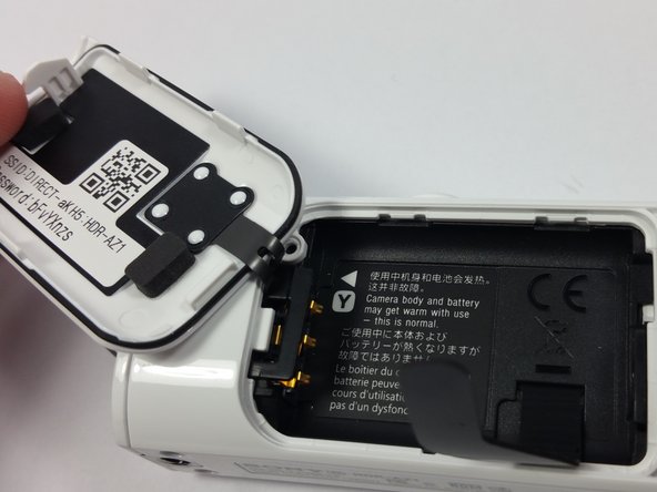

    • To access the battery, first make sure the camera is out of the case.
    • Push down on the door lock, located on the rear of the action cam.
    • The door is unlocked if the little yellow square is showing.
    • Pull on the panel door, located on the side opposite the LCD screen, and it should now pop open.
  2. Sony Action Cam Mini HDR-AZ1 Battery Door Replacement: crwdns2935265:02crwdnd2935265:01crwdnd2935265:03crwdne2935265:0 Sony Action Cam Mini HDR-AZ1 Battery Door Replacement: crwdns2935265:02crwdnd2935265:02crwdnd2935265:03crwdne2935265:0 Sony Action Cam Mini HDR-AZ1 Battery Door Replacement: crwdns2935265:02crwdnd2935265:03crwdnd2935265:03crwdne2935265:0
    • Open the side panel outward to reveal the battery.
    • Be sure not to break the small piece of plastic securing the door to the camera.
    • Use the pull tab to pop the battery out of place.

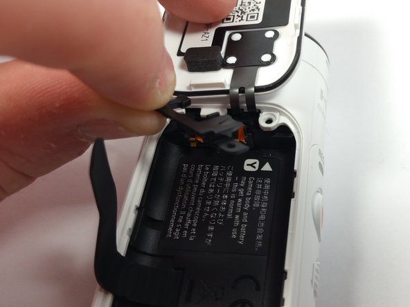

  3. Sony Action Cam Mini HDR-AZ1 Battery Door Replacement, Battery Door: crwdns2935265:03crwdnd2935265:01crwdnd2935265:02crwdne2935265:0 Sony Action Cam Mini HDR-AZ1 Battery Door Replacement, Battery Door: crwdns2935265:03crwdnd2935265:02crwdnd2935265:02crwdne2935265:0
    • Remove the circled 4 millimeter black screw adjacent to where the door is attached.
  4. Sony Action Cam Mini HDR-AZ1 Battery Door Replacement: crwdns2935265:04crwdnd2935265:01crwdnd2935265:02crwdne2935265:0 Sony Action Cam Mini HDR-AZ1 Battery Door Replacement: crwdns2935265:04crwdnd2935265:02crwdnd2935265:02crwdne2935265:0
    • Grab the small black bracket holding the ribbon on which the door is attached and pull it out.
  5. Sony Action Cam Mini HDR-AZ1 Battery Door Replacement: crwdns2935265:05crwdnd2935265:01crwdnd2935265:01crwdne2935265:0
    • Pull the door straight back so the attaching ribbon is pulled taught and the door will come right off.
