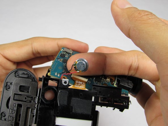

Sony Action Cam HDR-AS15 Speaker Replacement
  1. Sony Action Cam HDR-AS15 Speaker Replacement, Battery: crwdns2935265:01crwdnd2935265:01crwdnd2935265:01crwdne2935265:0
    • To access the battery, gently pry open the rear cover of the action cam.
  2. Sony Action Cam HDR-AS15 Speaker Replacement: crwdns2935265:02crwdnd2935265:01crwdnd2935265:02crwdne2935265:0 Sony Action Cam HDR-AS15 Speaker Replacement: crwdns2935265:02crwdnd2935265:02crwdnd2935265:02crwdne2935265:0
    • Using a pair of tweezers, firmly grip the protrusion where the PULL signifies and remove the tray and battery.
  3. Sony Action Cam HDR-AS15 Speaker Replacement, Disassembling Sony Action Cam HDR-AS15 Circuit Board: crwdns2935265:03crwdnd2935265:01crwdnd2935265:03crwdne2935265:0 Sony Action Cam HDR-AS15 Speaker Replacement, Disassembling Sony Action Cam HDR-AS15 Circuit Board: crwdns2935265:03crwdnd2935265:02crwdnd2935265:03crwdne2935265:0 Sony Action Cam HDR-AS15 Speaker Replacement, Disassembling Sony Action Cam HDR-AS15 Circuit Board: crwdns2935265:03crwdnd2935265:03crwdnd2935265:03crwdne2935265:0
    • Open the bottom tab with your finger or a plastic opening tool.
    • Pull the tab out, not up, to remove it completely.
    • Remove the two screws from the device.
    • Use your fingers to remove the plastic plate.
  4. Sony Action Cam HDR-AS15 Speaker Replacement: crwdns2935265:04crwdnd2935265:01crwdnd2935265:01crwdne2935265:0
    • Separate the outer casing from the electronics by pushing on one of the ports toward the back end of the case. The electronics should slide right out.
  5. Sony Action Cam HDR-AS15 Speaker Replacement: crwdns2935265:05crwdnd2935265:01crwdnd2935265:02crwdne2935265:0 Sony Action Cam HDR-AS15 Speaker Replacement: crwdns2935265:05crwdnd2935265:02crwdnd2935265:02crwdne2935265:0
    • Remove the two 6.4 mm screws on the LCD side of the device using a Phillips #00 screwdriver.
    • Flip the LCD display downward to reveal the circuit board.
  6. Sony Action Cam HDR-AS15 Speaker Replacement, Removing the tape: crwdns2935265:06crwdnd2935265:01crwdnd2935265:02crwdne2935265:0 Sony Action Cam HDR-AS15 Speaker Replacement, Removing the tape: crwdns2935265:06crwdnd2935265:02crwdnd2935265:02crwdne2935265:0
    • Remove the tape holding the speaker down.
  7. Sony Action Cam HDR-AS15 Speaker Replacement, Removing the speaker: crwdns2935265:07crwdnd2935265:01crwdnd2935265:01crwdne2935265:0
    • Desolder the speaker wires from the circuit board
    • To desolder, turn the soldering iron on and let it heat up
    • Touch the tip of the soldering iron to one of the solder joints until it melts. This will happen very quickly.
    • Pull the wire out of the solder and remove the soldering iron.
    • Repeat the last 3 steps for the second wire
