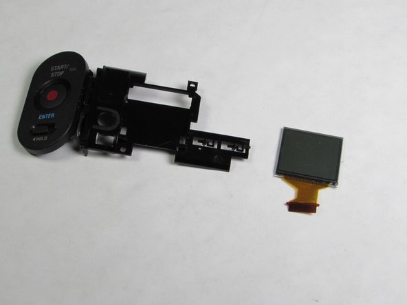

  10. Sony Action Cam HDR-AS15 LCD Screen Replacement, Removing the LCD: crwdns2935265:010crwdnd2935265:01crwdnd2935265:02crwdne2935265:0 Sony Action Cam HDR-AS15 LCD Screen Replacement, Removing the LCD: crwdns2935265:010crwdnd2935265:02crwdnd2935265:02crwdne2935265:0
    • Two clips hold in the LCD screen. Bend these back slightly with a plastic tool or with your hands while pushing on the front of the LCD screen so that the clips do not snap back into place
    • After the clips have been undone, use the plastic opening tools to pry out the LCD screen.
