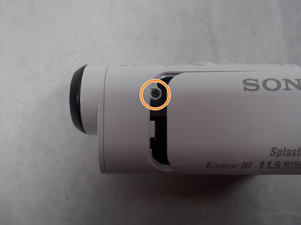

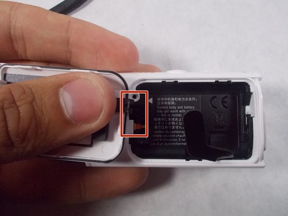

      • Start by removing the two screws on the bottom of the device using your small screwdriver, which should reveal the battery room.
      • Remove the screw inside the battery room.
      • Save these screws for later so they can be used to reassemble.

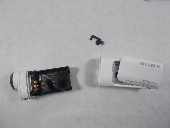

    2. Sony AZ1VR Speaker Replacement: crwdns2935265:02crwdnd2935265:01crwdnd2935265:01crwdne2935265:0
      • Once these are removed, slide the door out in the direction away from the screw holes.
      • Slide out the small piece of plastic with the door.

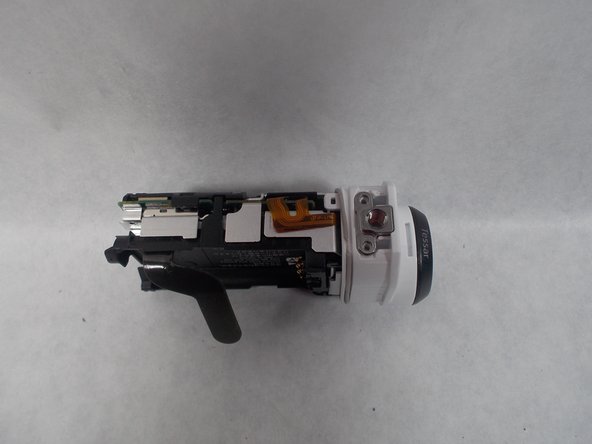

    4. Sony AZ1VR Speaker Replacement: crwdns2935265:04crwdnd2935265:01crwdnd2935265:01crwdne2935265:0
      • You'll see a screw on the top of the lens casing, in the white plastic towards the front. Remove this screw.

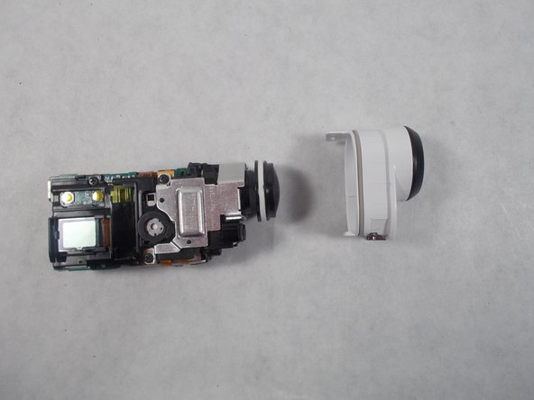

    5. Sony AZ1VR Speaker Replacement: crwdns2935265:05crwdnd2935265:01crwdnd2935265:02crwdne2935265:0 Sony AZ1VR Speaker Replacement: crwdns2935265:05crwdnd2935265:02crwdnd2935265:02crwdne2935265:0
      • Next pull the tabs on the bottom and top of the lens, and pull outward, this will remove the lens housing from the body.
      • Once removed, flip the device onto its side, leaving the LCD display facing up. This will be the side with the silver metal panel and rectangular screen.

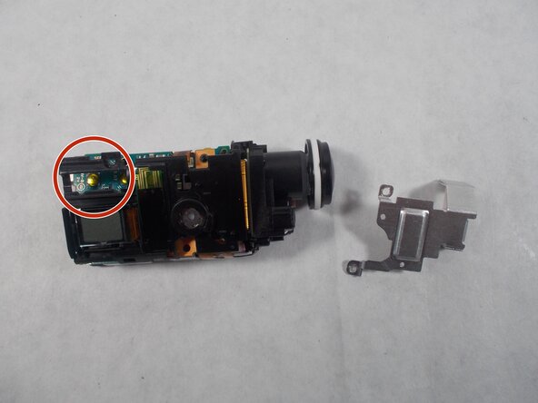

    6. Sony AZ1VR Speaker Replacement: crwdns2935265:06crwdnd2935265:01crwdnd2935265:01crwdne2935265:0
      • Carefully remove the screws connected to the silver metal plate.
      • Once done, remove the plate by pulling gently up on the back of the plate (the back end of the lens unit) and pushing it towards the front (the lens). It should slide out without too much resistance.

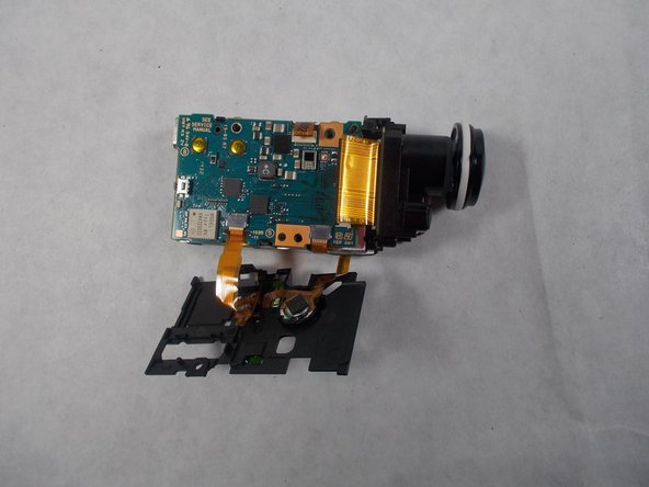

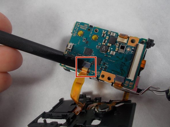

    8. Sony AZ1VR Speaker Replacement: crwdns2935265:08crwdnd2935265:01crwdnd2935265:01crwdne2935265:0
      • Use the spudger or other nondamaging tool to disconnect the speaker from the unit. This is done at the connection between the yellow cord/ribbon and the motherboard.
      • Remove the speaker from the plastic housing.
To reassemble your device, follow these instructions in reverse order. New speaker should be installed and connected in the same connection point as the previous speaker.
