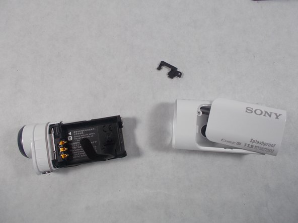

    • Remove the screws on the bottom of the device.
  2. Sony AZ1VR SD Battery Door Replacement: crwdns2935265:02crwdnd2935265:01crwdnd2935265:01crwdne2935265:0
    • Remove the screw within the battery housing.
  3. Sony AZ1VR SD Battery Door Replacement: crwdns2935265:03crwdnd2935265:01crwdnd2935265:02crwdne2935265:0 Sony AZ1VR SD Battery Door Replacement: crwdns2935265:03crwdnd2935265:02crwdnd2935265:02crwdne2935265:0
    • Pull out the small plastic bracket that holds the door in place.
