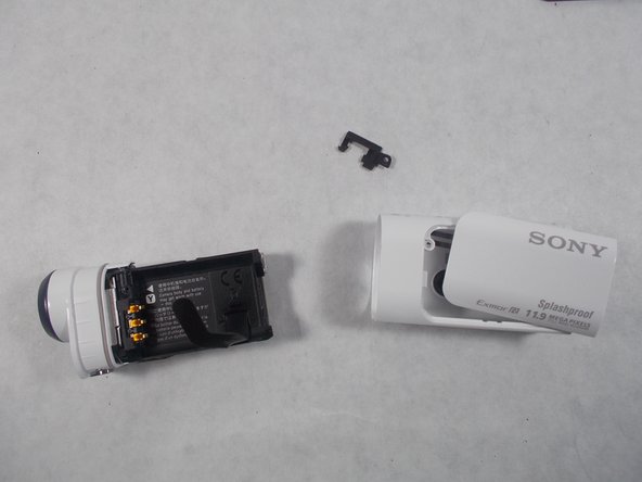

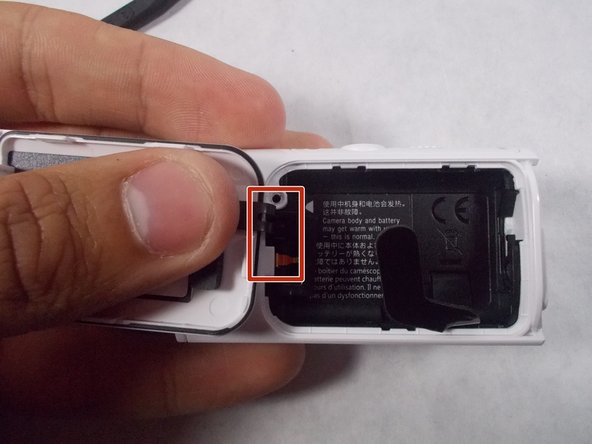

    • Start by removing the two screws on the bottom of the device using your small screwdriver, which should reveal the battery room.
    • Remove the screw inside the battery room.
    • Save these screws for later so they can be used to reassemble.
  2. Sony AZ1VR Microphones Replacement: crwdns2935265:02crwdnd2935265:01crwdnd2935265:01crwdne2935265:0
    • Once these are removed, slide the door out in the direction away from the screw holes.
    • Slide out the small piece of plastic with the door.

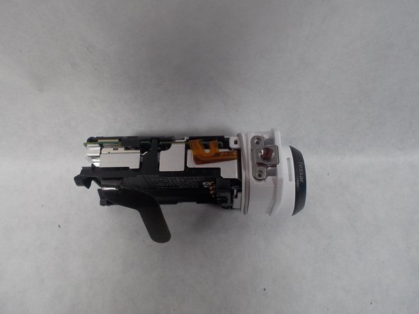

  3. Sony AZ1VR Microphones Replacement: crwdns2935265:03crwdnd2935265:01crwdnd2935265:01crwdne2935265:0
    • Now, locate the lens, the large domed piece in the front.
    • Grab the lens and pull the body gently out of the plastic. This will reveal the insides of the device.

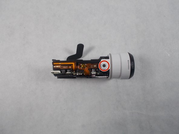

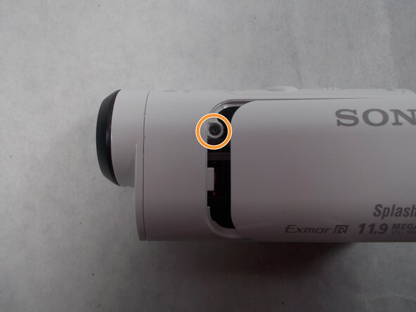

  4. Sony AZ1VR Microphones Replacement: crwdns2935265:04crwdnd2935265:01crwdnd2935265:01crwdne2935265:0
    • You'll see a screw on the top of the device, towards the front in the white plastic casing. Remove this screw.

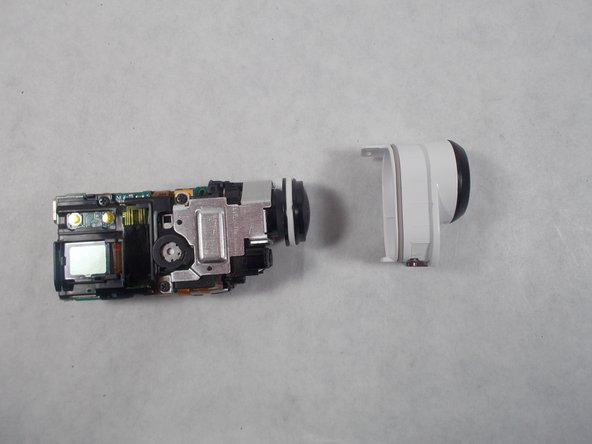

    • Next pull the tabs on the bottom and top of the lens, and pull outward, this will remove the lens housing from the body.
    • Once removed, flip the device onto its side, leaving the LCD display facing up. This will be the side with the silver metal panel and rectangular screen.

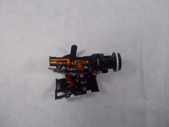

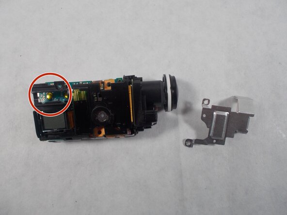

  6. Sony AZ1VR Microphones Replacement: crwdns2935265:06crwdnd2935265:01crwdnd2935265:01crwdne2935265:0
    • Carefully remove the screws connected to the silver metal plate.
    • Once done, remove the plate by pulling gently up on the back of the plate (the back end of the lens unit) and pushing it towards the front (the lens). It should slide out without too much resistance.
  7. Sony AZ1VR Microphones Replacement: crwdns2935265:07crwdnd2935265:01crwdnd2935265:03crwdne2935265:0 Sony AZ1VR Microphones Replacement: crwdns2935265:07crwdnd2935265:02crwdnd2935265:03crwdne2935265:0 Sony AZ1VR Microphones Replacement: crwdns2935265:07crwdnd2935265:03crwdnd2935265:03crwdne2935265:0

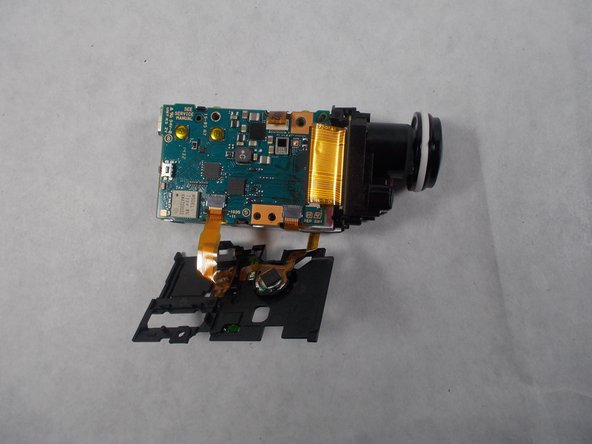

    • Now remove the screw directly above the LCD display, the thin rectangle near the rear of the lens unit. This will loosen the black plastic casing over the internal circuitry.
    • Pull the plastic up gently, it will be connected by cables on the bottom. Do not completely remove this plastic, leave it hinged onto the frame.
  8. Sony AZ1VR Microphones Replacement: crwdns2935265:08crwdnd2935265:01crwdnd2935265:01crwdne2935265:0
    • This will reveal the thick golden yellow cable at the front of the unit near the lens. Carefully pull this cable towards the front. The cable should not provide too much resistance if it is done correctly.

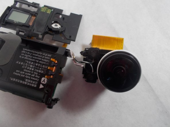

  9. Sony AZ1VR Microphones Replacement: crwdns2935265:09crwdnd2935265:01crwdnd2935265:02crwdne2935265:0 Sony AZ1VR Microphones Replacement: crwdns2935265:09crwdnd2935265:02crwdnd2935265:02crwdne2935265:0

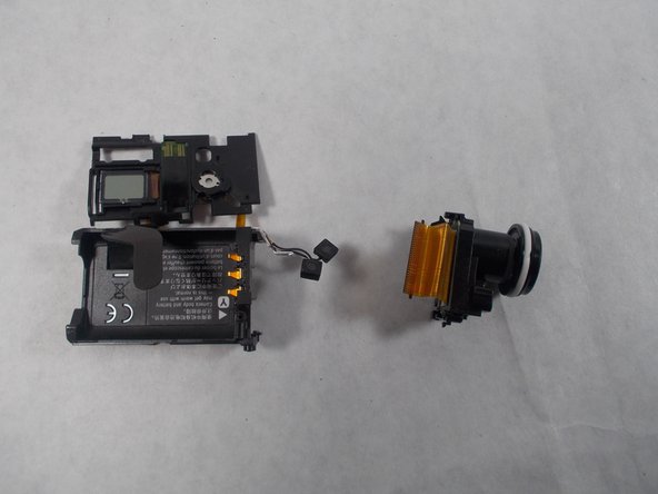

    • Next remove one last screw on the top of the device, and slowly pull the lens out.
    • You'll notice that the microphone is still connected to the lens, just pop these out and the lens is off.
    • Next unsolder the microphone cables from the board using the soldering iron. This can be accomplished by heating the existing soldered areas with the iron until they liquify and removing the connecting components.
    • Keep track of where each wire was soldered, and replace with the same wire in the new part. You can resolder them to the spots by reheating the area until the metal liquifies and placing the wire in.
