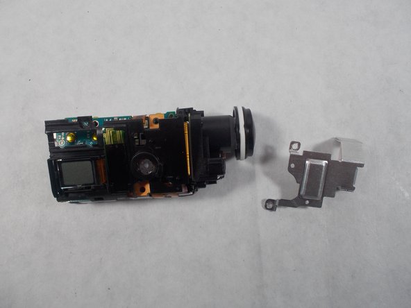

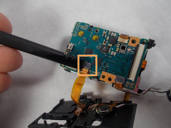

  3. Sony AZ1VR LCD Side Display Replacement: crwdns2935265:03crwdnd2935265:01crwdnd2935265:03crwdne2935265:0 Sony AZ1VR LCD Side Display Replacement: crwdns2935265:03crwdnd2935265:02crwdnd2935265:03crwdne2935265:0 Sony AZ1VR LCD Side Display Replacement: crwdns2935265:03crwdnd2935265:03crwdnd2935265:03crwdne2935265:0
    • Remove the screws connected to the silver metal plate.
    • Remove the plate by pulling the back up and pushing it towards the front.
    • Remove the screw directly above the LCD display.
    • Pull the plastic up gently, it will be connected by cables on the bottom.
    • Disconnect the cable going to the LCD display.
