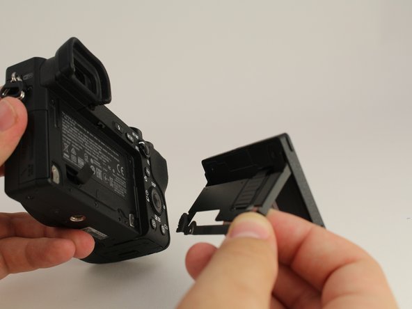

    1. Sony α6500 LCD Screen Replacement, LCD Screen: crwdns2935265:05crwdnd2935265:01crwdnd2935265:03crwdne2935265:0 Sony α6500 LCD Screen Replacement, LCD Screen: crwdns2935265:05crwdnd2935265:02crwdnd2935265:03crwdne2935265:0 Sony α6500 LCD Screen Replacement, LCD Screen: crwdns2935265:05crwdnd2935265:03crwdnd2935265:03crwdne2935265:0
      • To access the LCD assembly we need to remove the screws attaching its hinge to the camera body.
      • Remove four 3mm JIS 000 screws.
      • Remove one 3mm JIS 00 screw.
      • After dismounting the screen hinge be careful to not tear the black wire ribbon connecting the screen to the camera body.
    2. Sony α6500 LCD Screen Replacement: crwdns2935265:06crwdnd2935265:01crwdnd2935265:02crwdne2935265:0 Sony α6500 LCD Screen Replacement: crwdns2935265:06crwdnd2935265:02crwdnd2935265:02crwdne2935265:0
      • Remove the screen hinge from the camera.
      • Be careful to not tear the black flat cable connecting the lcd screen to the main body of the camera. This particular camera's cable has been cut for demonstration purposes.

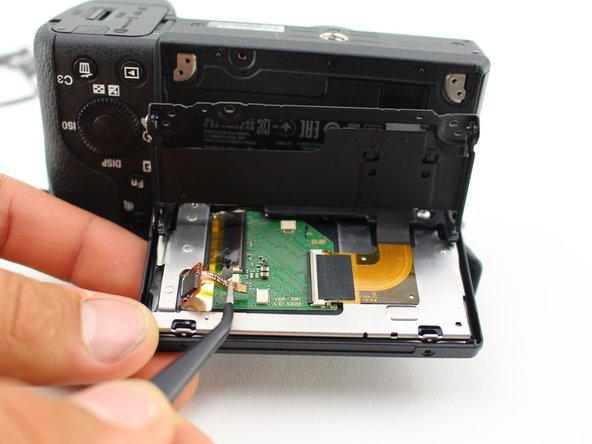

    5. Sony α6500 LCD Screen Replacement: crwdns2935265:09crwdnd2935265:01crwdnd2935265:02crwdne2935265:0 Sony α6500 LCD Screen Replacement: crwdns2935265:09crwdnd2935265:02crwdnd2935265:02crwdne2935265:0
      • Use the opening tool to pry open the back panel.
      • Remove the black plastic spacer laying on top of the circuit board.
    6. Sony α6500 LCD Screen Replacement: crwdns2935265:010crwdnd2935265:01crwdnd2935265:02crwdne2935265:0 Sony α6500 LCD Screen Replacement: crwdns2935265:010crwdnd2935265:02crwdnd2935265:02crwdne2935265:0
      • Carefully unplug the three wire ribbons from the circuit board with tweezers.
      • Likely you will need to wiggle the ribbons for a while before they come loose.
      • The ribbons can rip very easily, grasp the black plastic with the tweezers, on the two top ribbons, not the orange wires.
