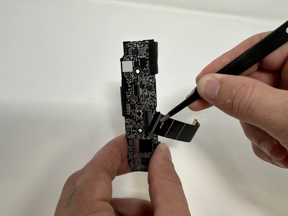

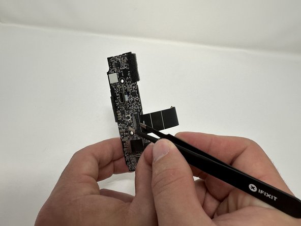

  18. Sonos Roam Large Ribbon Replacement, Large Ribbon: crwdns2935265:018crwdnd2935265:01crwdnd2935265:03crwdne2935265:0 Sonos Roam Large Ribbon Replacement, Large Ribbon: crwdns2935265:018crwdnd2935265:02crwdnd2935265:03crwdne2935265:0 Sonos Roam Large Ribbon Replacement, Large Ribbon: crwdns2935265:018crwdnd2935265:03crwdnd2935265:03crwdne2935265:0
    • Flip the inner circuit board around so the button and USB-C port are facing upward.
    • Use the tweezers to flip the large ribbon latch up.
    • Pull the large ribbon away from the inner circuit board to remove it.
