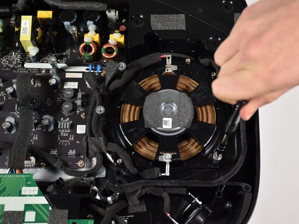

    1. Sonos Playbase Subwoofer Replacement, Subwoofer: crwdns2935265:04crwdnd2935265:01crwdnd2935265:02crwdne2935265:0 Sonos Playbase Subwoofer Replacement, Subwoofer: crwdns2935265:04crwdnd2935265:02crwdnd2935265:02crwdne2935265:0
      Pro Tech Toolkit
      $79.95
      • Remove the three 18mm T-20 length screws by turning counter-clockwise and pulling up.
      • Remove the three 38mm T-55 length screws by turning counter-clockwise and pulling up.

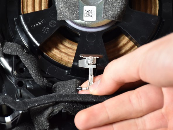

    2. Sonos Playbase Subwoofer Replacement: crwdns2935265:05crwdnd2935265:01crwdnd2935265:02crwdne2935265:0 Sonos Playbase Subwoofer Replacement: crwdns2935265:05crwdnd2935265:02crwdnd2935265:02crwdne2935265:0
      • Unclip the red and black wiring from the subwoofer by pulling them away from the subwoofer.
    3. Sonos Playbase Subwoofer Replacement: crwdns2935265:06crwdnd2935265:01crwdnd2935265:01crwdne2935265:0
      • Remove the subwoofer by gently lifting it up.
