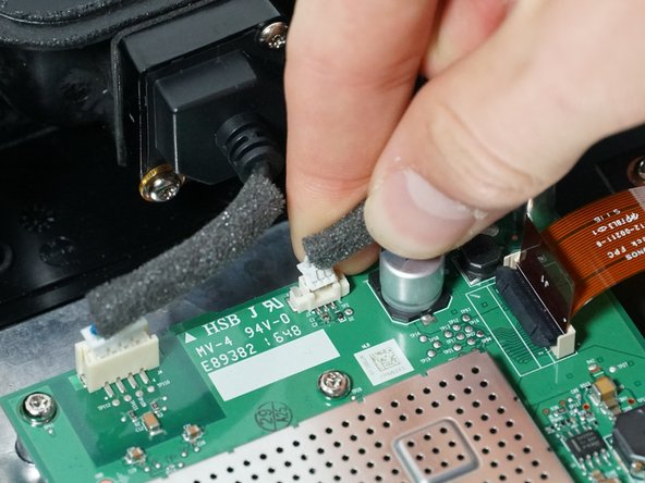

    • Unplug the optical audio port from the main circuit board by pinching the white clip and pulling upward.

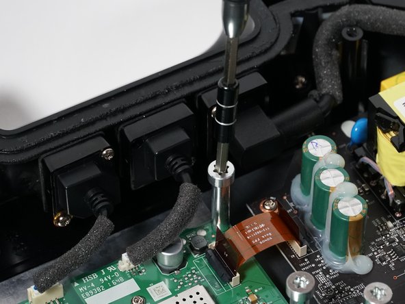

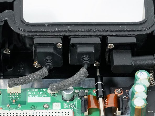

    • Remove the three 38mm T-55 screws preventing you from removing the Optical Audio Port screws by turning them counterclockwise.

    • Remove the two 18mm T-10 screws holding the Ethernet Port in place by turning them counterclockwise.

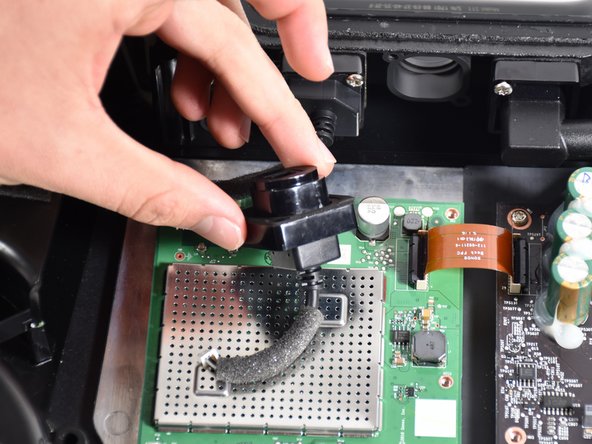

  7. Sonos Playbase Optical Audio Port Replacement: crwdns2935265:07crwdnd2935265:01crwdnd2935265:02crwdne2935265:0 Sonos Playbase Optical Audio Port Replacement: crwdns2935265:07crwdnd2935265:02crwdnd2935265:02crwdne2935265:0
    • Remove the Optical Audio Port from the housing by pinching the sides and pulling outward.
