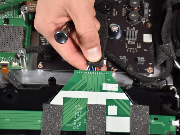

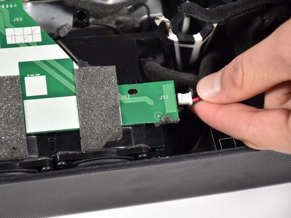

    2. Sonos Playbase IR Reciver Replacement: crwdns2935265:05crwdnd2935265:01crwdnd2935265:02crwdne2935265:0 Sonos Playbase IR Reciver Replacement: crwdns2935265:05crwdnd2935265:02crwdnd2935265:02crwdne2935265:0
      • Remove the side speakers from the green printed circuit board (PCB) running along the top of the main speaker array by pinching and pulling out the connector.
      • See Recognizing & Disconnecting Cable Connectors for more information.

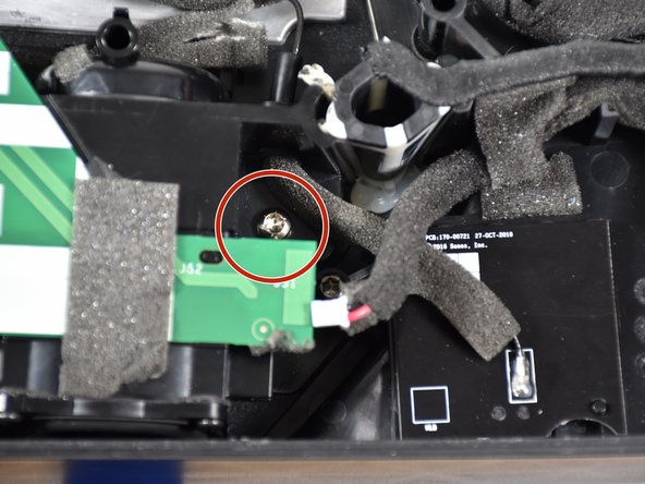

    3. Sonos Playbase IR Reciver Replacement: crwdns2935265:06crwdnd2935265:01crwdnd2935265:03crwdne2935265:0 Sonos Playbase IR Reciver Replacement: crwdns2935265:06crwdnd2935265:02crwdnd2935265:03crwdne2935265:0 Sonos Playbase IR Reciver Replacement: crwdns2935265:06crwdnd2935265:03crwdnd2935265:03crwdne2935265:0
      Pro Tech Toolkit
      $79.95
      • Remove the two 16mm T-20 screws located on both sides of the main speaker array by turning counter-clockwise.

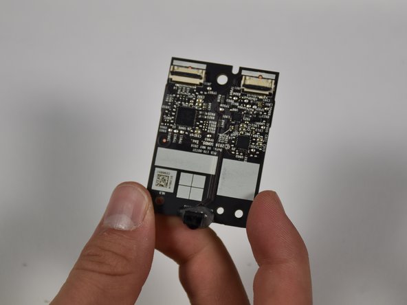

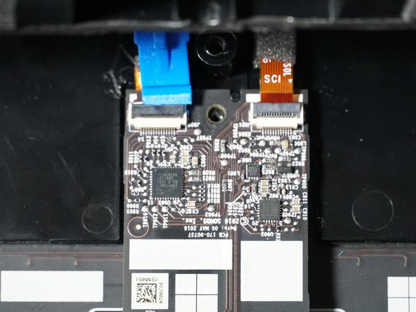

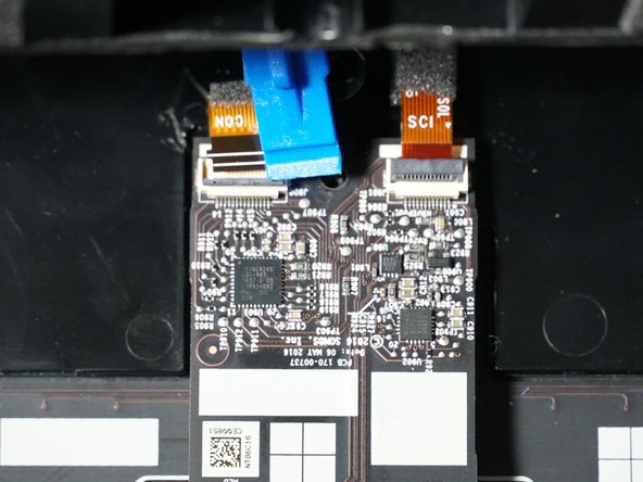

    1. Sonos Playbase IR Reciver Replacement, IR Receiver: crwdns2935265:09crwdnd2935265:01crwdnd2935265:03crwdne2935265:0 Sonos Playbase IR Reciver Replacement, IR Receiver: crwdns2935265:09crwdnd2935265:02crwdnd2935265:03crwdne2935265:0 Sonos Playbase IR Reciver Replacement, IR Receiver: crwdns2935265:09crwdnd2935265:03crwdnd2935265:03crwdne2935265:0
      Pro Tech Toolkit
      $79.95

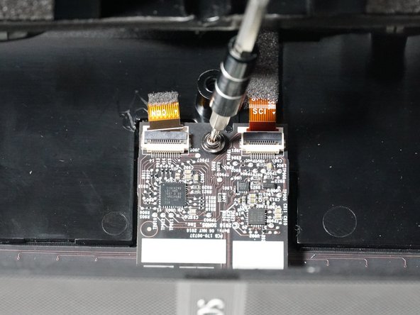

      • Lift the main speaker array to reveal the IR receiver underneath.
      • Remove the three 11 mm T-5 screws by turning counter-clockwise.
    2. Sonos Playbase IR Reciver Replacement: crwdns2935265:010crwdnd2935265:01crwdnd2935265:03crwdne2935265:0 Sonos Playbase IR Reciver Replacement: crwdns2935265:010crwdnd2935265:02crwdnd2935265:03crwdne2935265:0 Sonos Playbase IR Reciver Replacement: crwdns2935265:010crwdnd2935265:03crwdnd2935265:03crwdne2935265:0
    3. Sonos Playbase IR Reciver Replacement: crwdns2935265:011crwdnd2935265:01crwdnd2935265:02crwdne2935265:0 Sonos Playbase IR Reciver Replacement: crwdns2935265:011crwdnd2935265:02crwdnd2935265:02crwdne2935265:0
      • Remove the IR receiver by grasping it with two fingers and pulling up.
George Slivka
