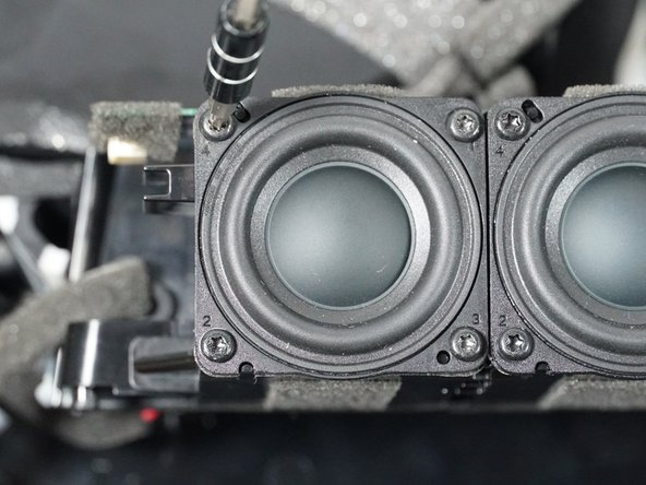

  9. Sonos Playbase A Speaker from the Main Array Replacement, Speaker from the Main Array: crwdns2935265:09crwdnd2935265:01crwdnd2935265:02crwdne2935265:0 Sonos Playbase A Speaker from the Main Array Replacement, Speaker from the Main Array: crwdns2935265:09crwdnd2935265:02crwdnd2935265:02crwdne2935265:0
    Pro Tech Toolkit
    $74.95
    • Remove the four 11mm T-10 screws from the individual speaker that needs replacement, by turning the screws counterclockwise.

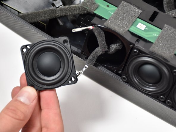

  10. Sonos Playbase A Speaker from the Main Array Replacement: crwdns2935265:010crwdnd2935265:01crwdnd2935265:01crwdne2935265:0
    • Remove the damaged speaker from the array socket, by grasping the speaker with one hand, the array with your other and pulling outward.
