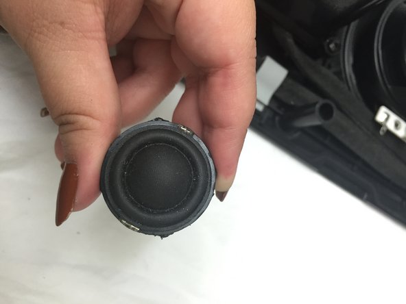

  8. Sonos Play 5 Tweeter Speaker Replacement, Tweeter Speaker: crwdns2935265:08crwdnd2935265:01crwdnd2935265:01crwdne2935265:0
    • After you unclip the connecters, locate the tweeter speaker.
    • Place your hand around the tweeter speaker and locate the area your going to start removing.
    • Remove any additional insulating foam around the tweeter speaker.
  9. Sonos Play 5 Tweeter Speaker Replacement: crwdns2935265:09crwdnd2935265:01crwdnd2935265:01crwdne2935265:0
    • Use the metal spudger that has a pointed curved tip to separate the soldered tweeter speaker.
    • The tweeter speaker is soldered to the front speaker panel, therefore use a prying motion to remove it.
    • This step will require the most amount of time- approximately 30 minutes to safely fully and properly separate the soldered part.
  10. Sonos Play 5 Tweeter Speaker Replacement: crwdns2935265:010crwdnd2935265:01crwdnd2935265:02crwdne2935265:0 Sonos Play 5 Tweeter Speaker Replacement: crwdns2935265:010crwdnd2935265:02crwdnd2935265:02crwdne2935265:0
    • The tweeter speaker is successfully removed
