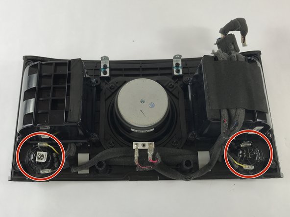

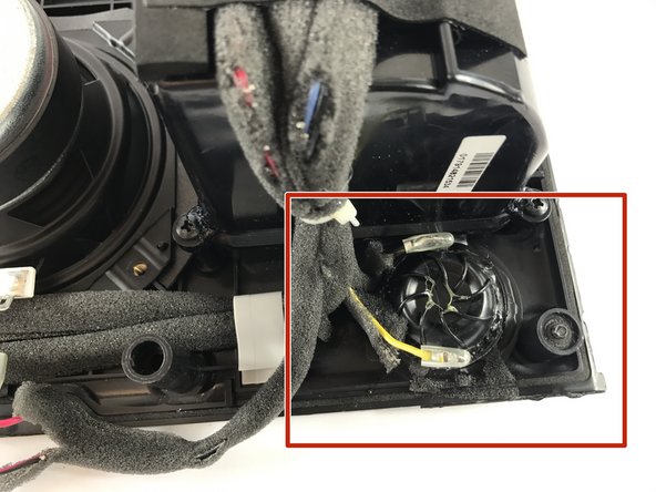

  7. Sonos Play 5 Tweeter  Replacement, Tweeter: crwdns2935265:07crwdnd2935265:01crwdnd2935265:03crwdne2935265:0 Sonos Play 5 Tweeter  Replacement, Tweeter: crwdns2935265:07crwdnd2935265:02crwdnd2935265:03crwdne2935265:0 Sonos Play 5 Tweeter  Replacement, Tweeter: crwdns2935265:07crwdnd2935265:03crwdnd2935265:03crwdne2935265:0
    • Locate the Tweeters on the back of the front panel assembly.

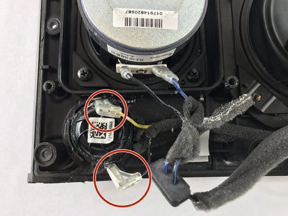

  8. Sonos Play 5 Tweeter  Replacement: crwdns2935265:08crwdnd2935265:01crwdnd2935265:02crwdne2935265:0 Sonos Play 5 Tweeter  Replacement: crwdns2935265:08crwdnd2935265:02crwdnd2935265:02crwdne2935265:0
    • Remove wires connected to the Tweeter.

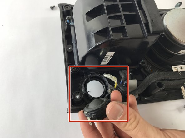

  9. Sonos Play 5 Tweeter  Replacement: crwdns2935265:09crwdnd2935265:01crwdnd2935265:02crwdne2935265:0 Sonos Play 5 Tweeter  Replacement: crwdns2935265:09crwdnd2935265:02crwdnd2935265:02crwdne2935265:0
    • Lightly push down on the tweeter and then twist it out gently counterclockwise.
    • Gently lift the tweeter out.
