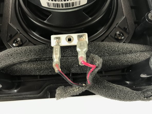

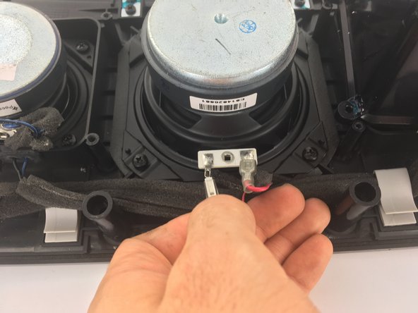

  7. Sonos Play 5 Subwoofer Replacement, Subwoofer: crwdns2935265:07crwdnd2935265:01crwdnd2935265:03crwdne2935265:0 Sonos Play 5 Subwoofer Replacement, Subwoofer: crwdns2935265:07crwdnd2935265:02crwdnd2935265:03crwdne2935265:0 Sonos Play 5 Subwoofer Replacement, Subwoofer: crwdns2935265:07crwdnd2935265:03crwdnd2935265:03crwdne2935265:0
    • Locate the red and black wires connected to the subwoofer.
    • Disconnect the red and black wires by pulling gently on the rubber ends attached to the connectors.

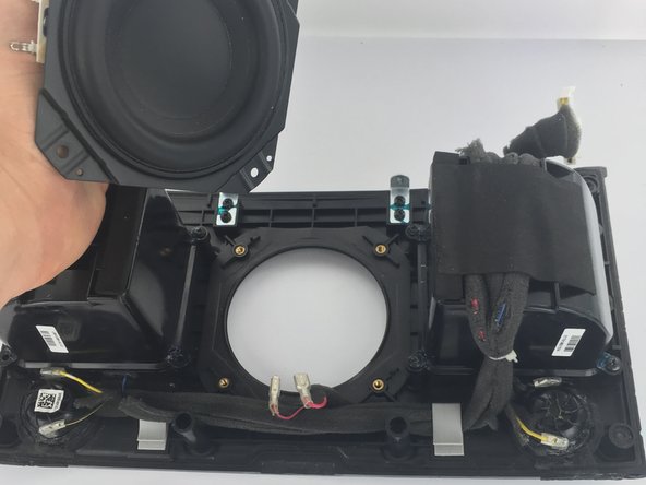

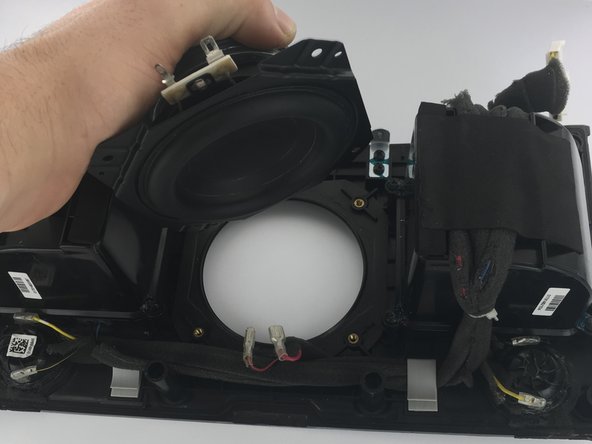

    • Remove the four 10mm long Phillips #2 screws on outer edge of the subwoofer.
    • If the screws are excessively tight, consider straight arm of some sorts to give yourself some leverage.
  9. Sonos Play 5 Subwoofer Replacement: crwdns2935265:09crwdnd2935265:01crwdnd2935265:03crwdne2935265:0 Sonos Play 5 Subwoofer Replacement: crwdns2935265:09crwdnd2935265:02crwdnd2935265:03crwdne2935265:0 Sonos Play 5 Subwoofer Replacement: crwdns2935265:09crwdnd2935265:03crwdnd2935265:03crwdne2935265:0
    • The subwoofer is now detached and able to be removed.
