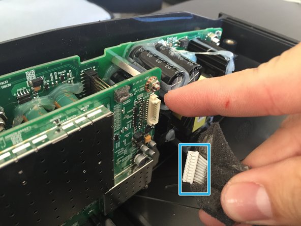

    • The most efficient way to reach the motherboard is to remove the attached amplifier and the motherboard as one unit.
    • Remove the cable connected to the amplifier by gently pulling the cable away from the amplifier.
    • The cable wiring is now disconnected from the amplifier.

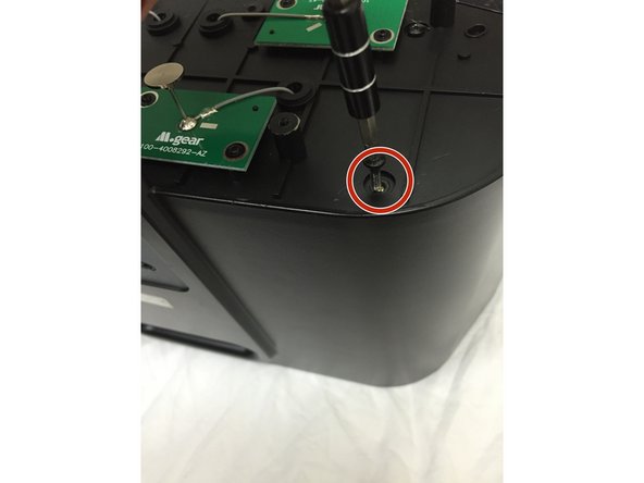

    • Turn the speaker upside down, with the volume buttons facing down.
    • Use a #1 Phillips-head screwdriver to remove the six 10 mm screws at the bottom of the speaker.

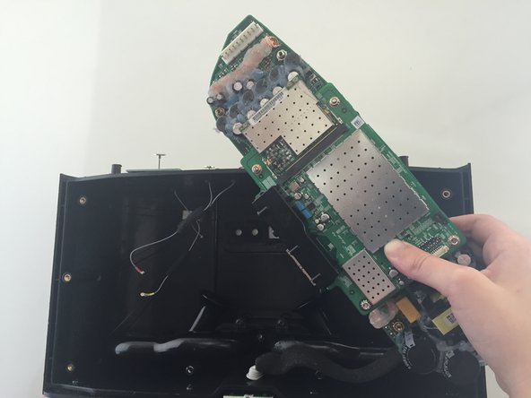

    • Gently lay the speaker flat, with the interior of the speaker facing the surface.
    • Slide out the amplifier and motherboard as one unit.
  14. Sonos Play 5 Motherboard and Amplifier Replacement: crwdns2935265:014crwdnd2935265:01crwdnd2935265:03crwdne2935265:0 Sonos Play 5 Motherboard and Amplifier Replacement: crwdns2935265:014crwdnd2935265:02crwdnd2935265:03crwdne2935265:0 Sonos Play 5 Motherboard and Amplifier Replacement: crwdns2935265:014crwdnd2935265:03crwdnd2935265:03crwdne2935265:0

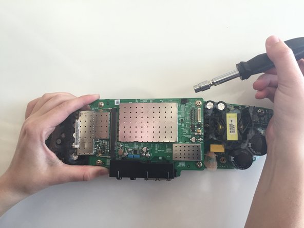

    • Use a 6 mm Allen socket to remove the four bolts attaching the amplifier to the motherboard.
    • Slowly lift the amplifier away from the motherboard.

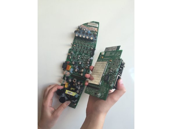

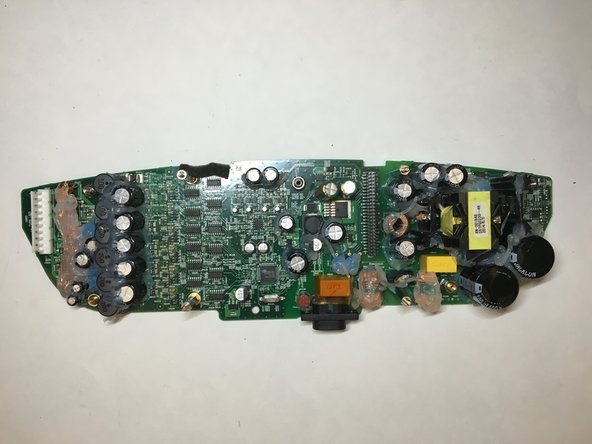

  15. Sonos Play 5 Motherboard and Amplifier Replacement: crwdns2935265:015crwdnd2935265:01crwdnd2935265:02crwdne2935265:0 Sonos Play 5 Motherboard and Amplifier Replacement: crwdns2935265:015crwdnd2935265:02crwdnd2935265:02crwdne2935265:0
    • The Motherboard and Amplifier now stand alone as single parts.
